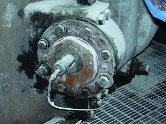

The pulverizer chosen for the vibration-monitoring project is a CE Raymond model 923 equipped with eight Wilcoxon 786A accelerometers (Figure 3). For the evaluation project, additional accelerometers were mounted on two motor sleeve bearings, two worm screw rolling element bearings, another bearing (at the bottom of the bull gear vertical shaft), every grinding roll, and three grinding roll journal assemblies.
3.	Shake, rattle, and roll. An accelerometer mounted on a grinding roll journal assembly. Courtesy: SKF USA Inc.

During the pilot period, half of the accelerometers were connected to a wireless vibration monitoring system from the San Diego-based SKF Reliability Systems division of SKF USA Inc.; the others were linked to a system from another vendor. Working from the sensors up, the test of the SKF system began by checking its ability to receive velocity and acceleration readings sent by machine condition transmitters (MCTs). The MCTs delivered general indicators of machine health like levels of imbalance and misalignment, but they also supplied specific variables such as enveloped acceleration (gE), a proxy for bearing degradation.
Although only eight accelerometers were employed, 10 MCTs were used. Two were doubled up, that is, the buffered output from one channel (the raw acceleration signal) served as the input to another in two separate situations. This daisy-chaining of MCTs allowed additional multiparameter measurements to be made without necessitating the installation of more sensors.
All of the MCTs measuring velocity were configured for a 1-inch-per-second (ips) full-scale range; those measuring enveloped vibration were configured for a full-scale range of 10 gE. The MCTs' 4- to 20-mA processed output was considered representative of the overall channel value. With the help of a 16-channel analog-to-digital converter, the 4- to 20-mA signals were converted to ModBus Ethernet (RS-485) format and sent wirelessly to the access point.
The wireless transceiver selected for the project was a Locus OS2400-485 industrial Ethernet radio from ProSoft Technology Inc. (Bakersfield, Calif.). All of the devices were DIN-rail mounted and fitted into a small, easy-to-mount enclosure. The system was installed and made fully operational in one day.
