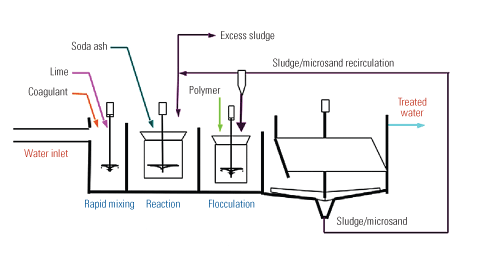

3. The Actiflo Softener water treatment process. Source: N.A. Water Systems
Both softening systems have a single treatment line that includes:
  • A dynamic mixing zone stage that creates rapid mixing conditions to destabilize anions by adding metallic salts, if necessary.
  • An enhanced precipitation reactor designed to improve the reaction of lime and carbonate ion with the hardness and natural alkalinity of water to form insoluble compounds.
  • An accelerated flocculation stage to provide rapid development of large settleable flocs.
  • A settling unit providing both gravity and enhanced lamella clarification. Sludge is recirculated and reinjected into the precipitation reactor to improve the precipitation kinetics and optimize chemical consumption.

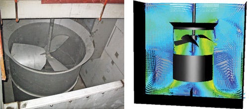

The precipitation reactor is a critical component in the high-rate processes, and it allows for complete homogenization of water and chemicals. The proprietary design of the draft-tube reactor (named Turbomix) combines the advantages of plug flow and complete mixing. It reduces the reactor tank volume by suppressing dead zones and decreases reagent loss by suppressing short circuiting (Figure 4). Sludge is recirculated in the reactor so that large crystals form quickly and retention time is reduced. Recycling the sludge also increases the sludge waste concentration and thus reduces the volume of sludge for disposal.
4. High-rate reactor. A proprietary draft tube reactor (L) was designed using specialized computer design tools (R) to maximize plug flow and complete mixing. Courtesy: N.A. Water Systems
The reactor immediately downstream from the precipitation reactor is used to slowly mix the precipitated particles with a flocculating polymer and promote the formation of large flocs. The Actiflo process includes the introduction of micro-sand at this point to act as a nucleus for the flocs. The ballasted flocs settle very rapidly and provide the system with its very high rising velocity. The sand is cleaned and recovered for reuse through the use of hydrocyclones. The final stage includes a clarification tank with lamella-enhanced settling.
By comparison, the Multiflo system does not use sand in the recirculation loop, but it can handle a higher solids loading than Actiflo and will provide sludge thickening in the lamella settling step. The choice between the two technologies depends upon the influent water flow rate and characteristics.
