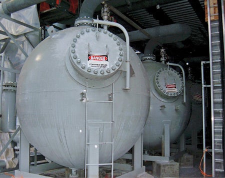

A deep-bed polisher is typically employed in applications requiring very pure condensate, where it’s vital to remove every trace of contamination. This polisher contains a mixture of cation and anion resin beads in a bed about 3 to 4 feet deep. The resin mixture can consist of varying cation-to-anion resin ratios, depending on the amount of dissolved contaminants expected, with 2-to-1 and 1-to-1 resin ratios being the most common.
Due to the large volume of resin present, the ion exchange capacity of this type of polisher is high; however, its filtering capability is limited. Large quantities of total suspended solids can cause plugging and high pressure drop issues in deep-bed condensate polishers. Filtered particles may also cause fouling of the resin, particularly the anion resin beads, and loss of polisher efficiency (Figure 1).
1. Going deep. This spherical vessel deep-bed condensate polisher system was installed at a once-through pulverized coal-fired power generating facility. Courtesy: Bechtel Power Corp.
Deep-bed condensate polishers are favored in applications where high levels of total dissolved solids (TDS) are present (such as those using sea or brackish waters), where the plant must continue operation with small condenser leaks, and at plants that have minor air in-leakage control problems.
Nuclear power plants normally require deep-bed condensate polishers because their steam systems are sensitive to even minimal levels of contamination. The extremely low cation conductivity limits (<0.15 µS/cm) associated with operation on OT chemistry also call for deep-bed condensate polishers in supercritical and ultrasupercritical plants. Also, EPRI’s latest AVT guidelines recommend condensate polishers on most high-pressure units, advocating that they maintain steam cation conductivity of <0.15 µS/cm.
