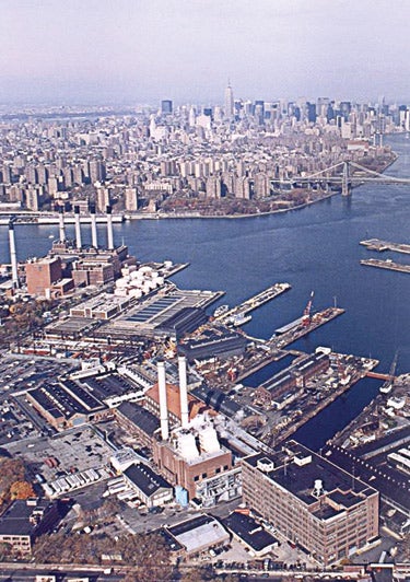

Tucked away in one corner of the yard is the Brooklyn Navy Yard Cogeneration (BNYC) facility – the lifeblood of this thriving complex and an important part of the New York electric and steam systems. BNYC (Figure 1), by virtue of its strategic location across the East River from downtown Manhattan, provides steam to Consolidated Edison's (ConEd) steam system, Brooklyn Navy Yard Development Corp. (BNYDC), and New York City's Red Hook Wastewater Treatment Plant. Electricity is sold to ConEd under a long-term power purchase agreement.
 1. Location, location, location. The Brooklyn Navy Yard Cogeneration Facility provides power to the Consolidated Edison grid and steam to Consolidated Edison's steam heat system in Manhattan, across the East River. Courtesy: Delta Power Co.
2. Steamy business. The cogeneration plant consists of two 120-MW Siemens gas turbines, two HRSGs, and two 40-MW steam turbines. Turbine exhaust steam is sent to the steam heat system. Courtesy: Delta Power Co.

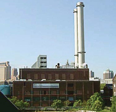

3. Historic yard. The Brooklyn Navy Yard Cogeneration Facility is located in the Brooklyn Navy Yard Development Corp.'s 300-acre industrial park. Courtesy: Delta Power Co.
