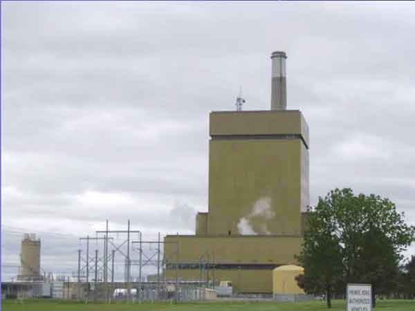

Otter Tail Power Co.’s Big Stone Plant Unit 1, located in Milbank, South Dakota, is a 475-MW plant that burns Powder River Basin (PRB) coal (Figure 1). This unit was originally outfitted with an electrostatic precipitator (ESP) when it was constructed in 1975. During the mid-1970s the number of ESPs installed on coal-fired boilers across the U.S. spiked in response to the Clean Air Act of 1970. The long-established technology of the ESP was at the time considered the best choice to meet the particulate emission requirements of the Clean Air Act.
1.    ESP upgrade needed. Big Stone Unit 1 elected to use the casings of its electrostatic precipitator (ESP) to house a pulse jet fabric filter. The upgrade not only ended unit derates for opacity excursions and induced draft fan pressure drop limitations, but the new equipment also performs well enough to meet anticipated future fine particulate matter legislation. Courtesy: Buell APC
