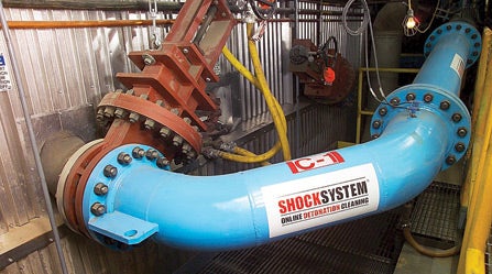

A new technology was introduced to the U.S. power generation industry about five years ago. It uses detonation cleaning, derived from Pratt & Whitney’s Pulse Detonation Engine, which is used to power a supersonic craft (Figure 1). The engineers developing the futuristic pulse detonation engine could not have foreseen that this technology would migrate into the electric power industry as the most novel boiler cleaning technology to come along in many years. The new ShockSystem detonation cleaning combustor (Figure 2) has nothing to do with using dynamite or detonating cord when a unit is off-line—the most invasive cleaning method still in use. Nor does it refer to other on-line cleaning system options such as sonic horns or water canons.

2. Simple system design. A typical Pratt & Whitney ShockSystem combustor used for on-line boiler cleaning. Courtesy: Pratt & Whitney MMI

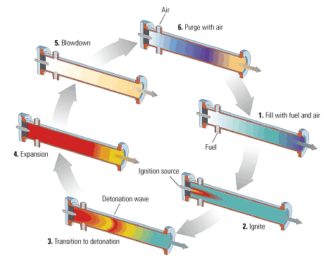

The process of creating a detonation consists of injecting a mixture of fuel and oxidizer into a chamber, igniting this mixture, transitioning the resulting combustion wave to a detonation wave, and then purging with air to prepare for the next cycle (Figure 3). The detonation wave travels at supersonic speeds within the combustion chamber and quickly decays to a blast wave once it leaves the chamber and propagates in open space (or within a large structure, such as a boiler). The blast wave—also known as a pressure wave, a pressure pulse, or simply an impulse—has the energy required to remove sintered and unsintered ash in the backpass of boilers. This pressure wave has little to no negative effects on tube erosion, and the required operational frequency is much less than that of acoustic horns.
3. Inside workings. This drawing illustrates the ShockSystem operating cycle. Source: Pratt & Whitney MMI
Detonation cleaning creates a blast wave that propagates omnidirectionally from the combustor exit. To date, all applications have been mounted outside the boiler wall and direct the blast wave through a penetration. These applications have been installed on both positive and balanced draft boilers. The benefit of this type of installation is that the combustion chamber can be installed along the boiler wall or routed around external structures without risking the loss of a lance tube due to bending, getting stuck, or breaking off during operation. Another major advantage boiler operators see is that the pressure waves are controlled and applied on-line, thus eliminating unnecessary outages. The long-term effects on tube erosion are minimal, plant emissions are lowered, exit gas temperature is decreased, and overall boiler efficiency is increased.
