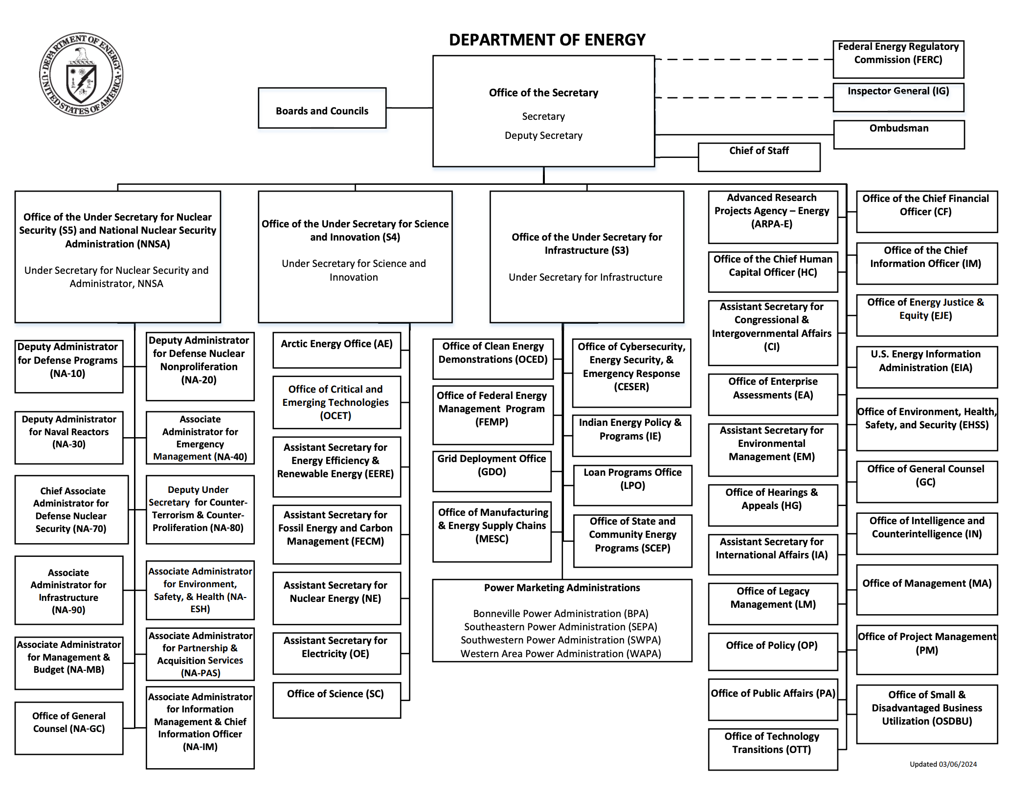

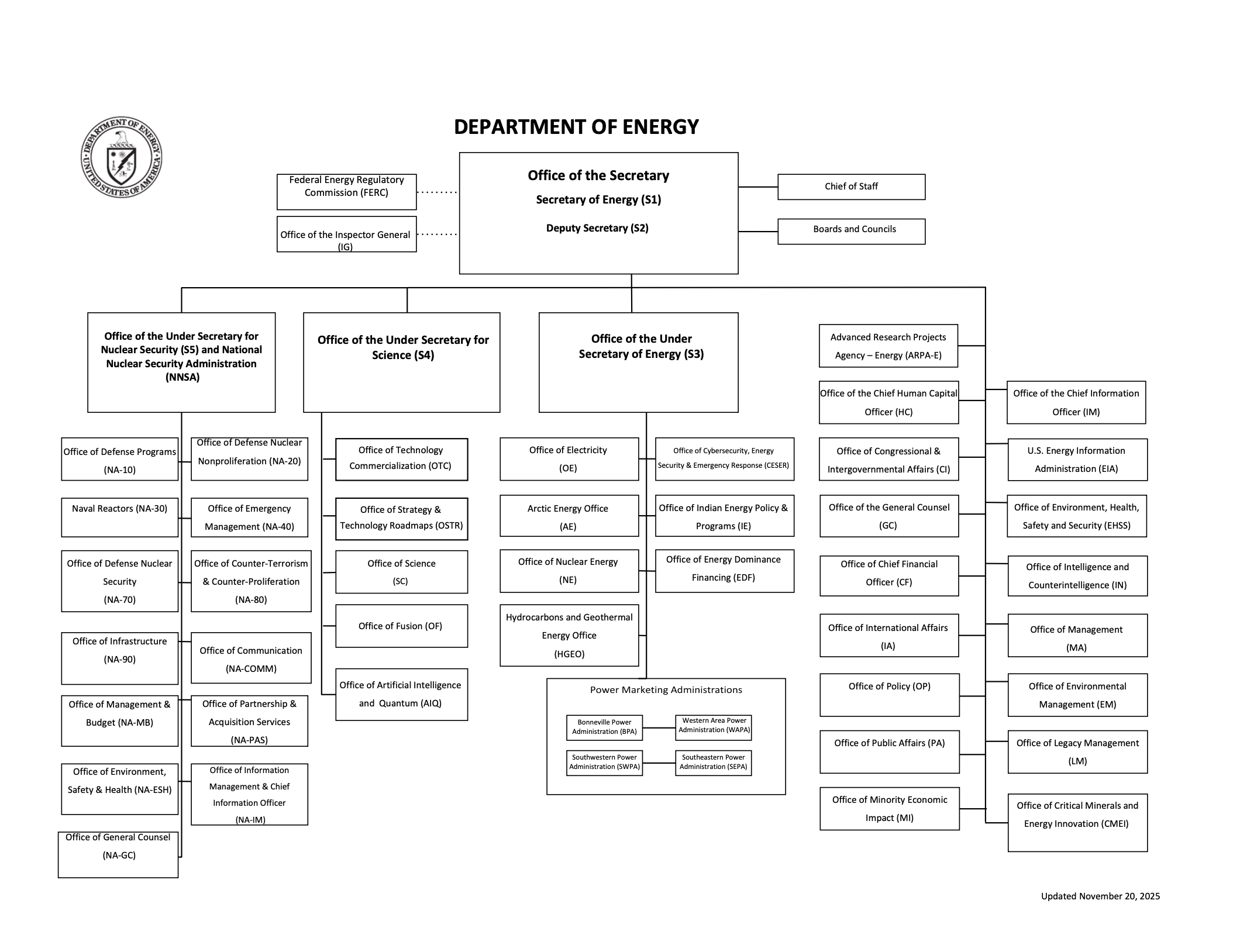

The measures reflect yet another facet in a broader institutional pivot within the DOE. On Nov. 20, 2025, notably, the agency unveiled an updated organizational chart that elevates the Office of Cybersecurity, Energy Security and Emergency Response (CESER)— the office that issued the new Section 202(c) orders—while creating new offices for Hydrocarbons and Geothermal Energy, Energy Dominance Financing, and Artificial Intelligence and Quantum. Compared to the DOE’s 2024 structure, the realignment has effectively eliminated the Office of Energy Justice and Equity, the Office of Clean Energy Demonstrations, and the Grid Deployment Office. The move has seemingly sidelined the Biden administration’s clean-energy infrastructure focus while consolidating the Trump administration’s mission around fossil fuel preservation, emergency grid management, and advanced technology.
DOE organizational chart – March 2024
March 2024: DOE organizational structure prior to the 2025 realignment. Source: DOE (March 2024)
DOE organizational chart – November 2025
November 2025: Revised DOE organizational chart after the realignment. Source: DOE (November 2025)

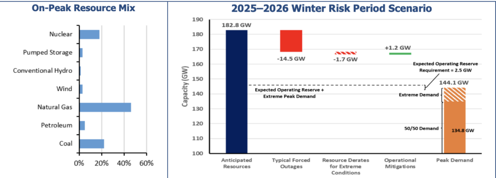

PJM’s 2025–2026 winter risk scenario shows that while the region maintains 182.8 GW of anticipated resources, typical winter forced outages of 14.5 GW and an additional 1.7 GW of extreme-weather derates substantially reduce available capacity during severe cold events. Extreme peak demand could reach 144.1 GW—well above the 134.8-GW 50/50 forecast—leaving only a narrow buffer above NERC’s 2.5-GW operating reserve requirement even after 1.2 GW of expected operational mitigations. Natural gas and coal make up the majority of on-peak resources. Source: NERC 2025–2026 Winter Reliability Assessment.

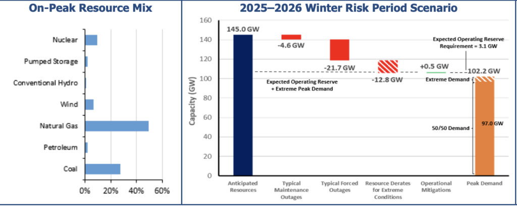

MISO’s 2025–2026 winter risk scenario indicates tighter conditions, with anticipated resources of 145.0 GW offset by 4.6 GW of typical maintenance outages, 21.7 GW of typical forced outages, and 12.8 GW of extreme-weather derates. Under an extreme peak of 102.2 GW—versus a 97.0-GW 50/50 forecast—the region retains only a small margin above NERC’s 3.1-GW operating reserve requirement, even after 0.5 GW of operational mitigations. Natural gas and coal dominate the on-peak resource mix. Source: NERC 2025–2026 Winter Reliability Assessment.
