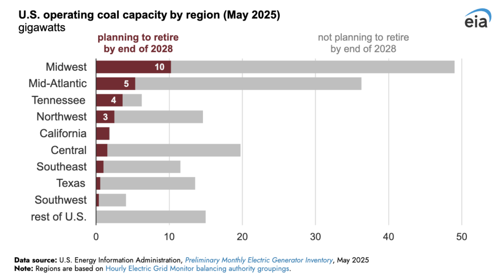

So far, at least nine of the 16 Section 202(c) orders have targeted coal-fired units, collectively preventing the retirement of more than 4.5 GW of coal capacity across Michigan, Pennsylvania, Washington, Indiana, and Colorado through early 2026. For reference, approximately 166-172 GW of coal capacity was operational in the U.S. as of mid-2025, according to the Energy Information Administration.
U.S. operating coal capacity by region, showing that nearly 60% of planned coal retirements through 2028 are concentrated in the Midwest and Mid-Atlantic—regions now at the center of DOE emergency orders delaying unit closures.Source: U.S. Energy Information Administration (May 2025 Preliminary Monthly Electric Generator Inventory)
U.S. operating coal capacity by region as of May 2025, showing that nearly 60% of planned coal retirements through 2028 were concentrated in the Midwest and Mid-Atlantic—regions now at the center of DOE emergency orders delaying unit closures. The data reflects power plant retirement schedules as reported prior to recent federal intervention.
Source: U.S. Energy Information Administration (May 2025 Preliminary Monthly Electric Generator Inventory).
