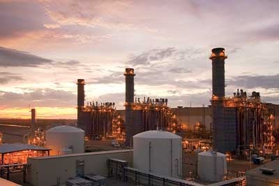

The New Harquahala Generating Project (HGP), owned by MACH Gen LLC, is a 1,080-MW combined-cycle plant located in Maricopa County, Arizona, about 60 miles west of Phoenix. HGP entered commercial service late in 2004 and sells into the merchant power market in the southwestern U.S., primarily to Arizona utilities, especially during the July to November time frame, when the plant runs almost continuously. MACH Gen retained Competitive Power Ventures Inc. (CPV) a couple of years ago to serve as the plant’s asset manager, and NAES Corp. was selected as the operations and maintenance (O&M) provider. The plant reports an annual capacity factor around 30%, not unlike many merchant gas-fired combined-cycle plants across the nation.
Each of the plant’s three units is configured in a unique 1 x 1 configuration based on the Siemens SGT6-6000G (formerly W501G) gas combustion turbines. To give you some idea of the scale of this project, HGP is essentially the PGE Port Westward 1 x 1 project (profiled as a 2007 Top Plant in our September 2007 issue) times three (Figure 1). Each of the three Siemens 120-MW SST6-PAC 3000 steam turbines includes a high-pressure and combined intermediate-pressure/low-pressure section. NEM supplied the three-pressure heat-recovery steam generators (HRSGs) that have been remarkably trouble-free in spite of the plant’s routine cycling.
1. Desert dweller. The New Harquahala Generating Project, located west of Phoenix, Arizona, is a 1,080-MW plant with three 1 X 1 combined-cycle units. The gas turbine is a Siemens SGT6-6000G outfitted with steam injection for power peaking. Courtesy: Harquahala Generating Corp.
Net plant heat rate is on the order of 7,100 Btu/kWh, which places the plant at the top of the food chain as far as plant efficiency is concerned. Power reaches the Palo Verde 500-kV grid through an HGP-owned 23-mile transmission line that connects to the Salt River Project Hassayampa switchyard and ultimately to the Palo Verde grid. Uniquely, the plant’s switchyard and transmission line, operated under contract by Constellation Energy, are considered a separate control area under North American Electric Reliability Corp. (NERC) rules.

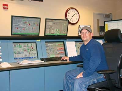

2. Efficient layout. As part of the T3000 control system upgrade, the human-machine interface layout of the control panels, monitors, and room were rearranged. The footprint of the control panel was reduced considerably, yet system capability increased significantly. Lead O&M Technician Lamont Packer demonstrated many of the advanced features of the T3000. Source: POWER

Long-Term, Intangible Benefits. The T3000 system was developed to have a greatly simplified user and engineering interface with easy access to all user-developed screens at any terminal. In fact, the HMI interface allows operators to save their favorite screens and reports layouts, including colors, in a specific user setting associated with a user name. Log in when your shift begins, and your customized set of screens appear. This flexible design effectively speeds operating controls technician training by reducing reliance on supplier customer support.
My favorite feature was the excellent organization of the vast stores of information available to anyone in the plant with a terminal. It only takes two mouse clicks to access any system screen — fewer than are necessary to access email on my cell phone. Additionally, an operator can trend any combination of variables in the plant over any period of time. Just drag and drop the variable names from the flow diagrams into a new trend window and select the time scale. The entire performance database history is online and immediately accessible from the server in just a couple of mouse clicks.
The T3000 also offered the plant significantly expanded support for creating, testing, and implementing logic changes to the control system. Periodically, logic changes are necessary for plant optimization, system protection, or personnel safety. The TXP system has no program for testing these logic changes prior to going "live" and therefore requires a plant to shut down for installation and testing. The T3000 allows logic changes and executes those changes in a simulated T3000 program. That program then automatically identifies and flags any logic flaws, giving the engineer an opportunity to make corrections, thereby insulating the plant from unexpected trips.
One other big advantage the T3000 has over the TXP is that it operates on a thin client, so a complete program is available from any PC in the plant or outside the plant via an Internet connection (if allowed) and allows remote operation of the facility independent of the control room. This capability is a requirement for all transmission operators to satisfy NERC standards, and HGP may be required to comply with those standards in the future as the transmission line and substation are considered a control area by NERC. HGP negotiations on these fine points of the NERC standards continue.
