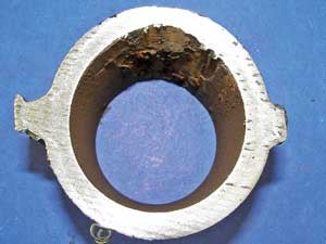

1.    Excessive boiler tube deposits and blistering. These preboiler corrosion products were deposited on the inner diameter surface near welds on the smooth tube portion. Deposits were up to seven times heavier on smooth tube than on rifled tube surfaces (~375 g/ft2) . The tube experienced short-term overheating (blistering) as well as other damage. Courtesy: Sheppard T. Powell Associates LLC

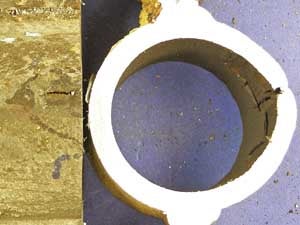

2.    Heavy boiler tube deposits, overheating, fatigue, and fireside corrosion. The end view and outer diameter of the tube are shown in these images. The tube had heavy (146 g/ft2) internal deposits and had experienced long-term overheating, creep, thermal fatigue cracking, and fireside corrosion. Courtesy: Sheppard T. Powell Associates LLC

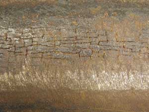

3.    Boiler tube failure.
The left side of the photograph shows the crack on the tube’s outer diameter. The right side shows an end view of the blistering and cracking from hydrogen damage. Heavy deposits formed on the tube surface, causing high temperatures, swelling, underdeposit concentration of trace acidic salts in the boiler water, underdeposit corrosion, hydrogen damage, and tube failures. Courtesy: Sheppard T. Powell Associates LLC
Since the most recent cleaning, the deposit accumulation rates for the two units had been 7.8 g/ft2/year and 8.9 g/ft2/year, and the total deposit loading during our visit was well above the level at which a chemical cleaning is recommended. When plants have accumulation rates over about 5 g/ft2/year, it is a sign of poorer-than-average control of iron transport and/or an unusually high localized deposition/corrosion mechanism. Plants with <1 to 2 g/ft2/year of deposit accumulation rate have good control.
For an earlier period with a higher deposit accumulation rate (10.7 g/ft2/year), iron transport rates were estimated to be about 26 ppb as iron in the feedwater (based on material removed and estimated total feedwater flow). For the more recent period, the iron transport rate was estimated to be 18 to 22 ppb as iron in the feedwater. The data also indicated that the rate of iron oxide transport during normal operation remains elevated.
