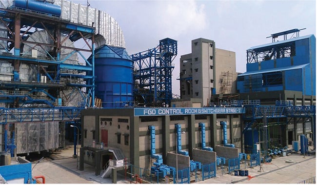

1. Flue gas desulfurization (FGD) systems are a highlight of the NTPC Vindhyachal plant. All 13 of the facility’s coal-fired units will have FGD systems installed by mid-2026. Courtesy: NTPC
Rajeev Kumar, an additional general manager at NTPC, said all 13 of those units by the middle of 2026 will have FGD systems (Figure 1) installed as part of NTPC’s ongoing desulfurization strategy. “NTPC has taken steps with the objective toward decarbonization, and to be positioned as a low-carbon electricity generator to support India’s climate change targets,” said Kumar, noting NTPC wants to take a lead role because of its status as India’s leading integrated power company. NTPC has plans to achieve 60 GW of renewable capacity by 2032.

Kumar told POWER: “At present, a flue gas desulfurization system has been commissioned in Units 10, 12, and 13, which are each 500-MW units. The Unit 8 and Unit 11 FGD system trial operation is in progress”; Kumar said commissioning was expected in September. “The FGD target date for Units 9 and 7 is October of this year, respectively. The target date for Units 1 to Unit 6, is April 2026,” said Kumar.
