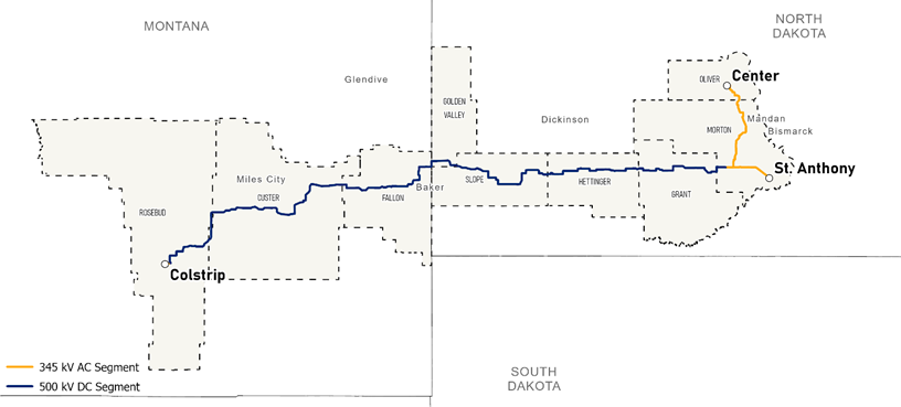

The North Plains Connector will extend roughly 420 miles from an existing substation in Colstrip, Montana, to two separate endpoints in North Dakota—one near the town of Center and the other near St. Anthony. This configuration enables the line to interface with three major regional markets: the Western Electricity Coordinating Council (WECC) through the Colstrip connection, the Midcontinent Independent System Operator (MISO) via the Center endpoint, and the Southwest Power Pool (SPP) through the St. Anthony terminal. Courtesy: Grid United
