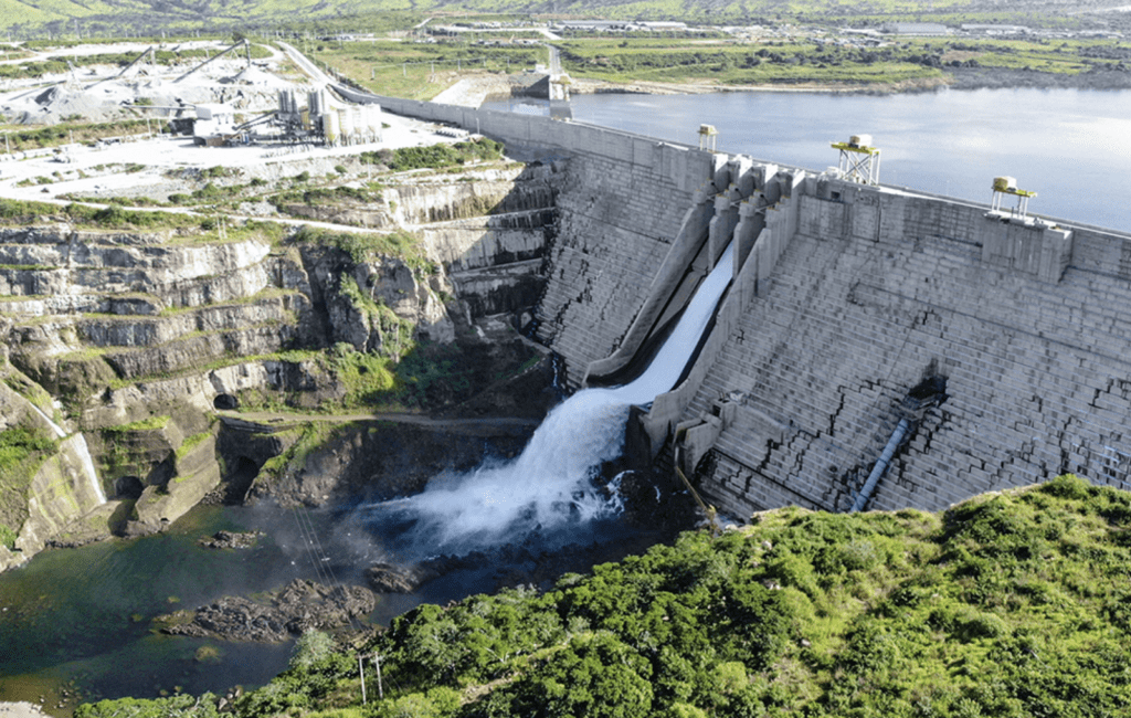

1. The International Hydropower Association compiles data on hydropower installations worldwide. The group this year said China has the most installed hydro generation capacity, at 341 GW, followed by the U.S., Brazil, and Canada. Courtesy: 2018 Hydropower Status Report, International Hydropower Association
The International Hydropower Association (IHA) this year said China leads the world with 341 GW of installed hydro capacity, followed by the U.S. with 103 GW, Brazil with 100 GW, and Canada with 81 GW (Figure 1).
