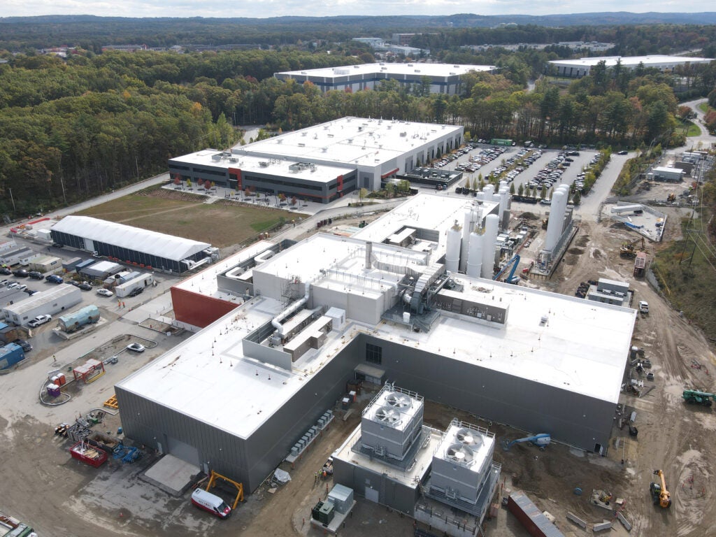

Commonwealth Fusion Systems’ campus in Devens, Massachusetts, is home to its SPARC facility (in the foreground) and its magnet factory (farther away). In the factory, CFS builds the superconducting magnets that are key to the SPARC fusion machine that’s now under construction. Source: Commonwealth Fusion Systems

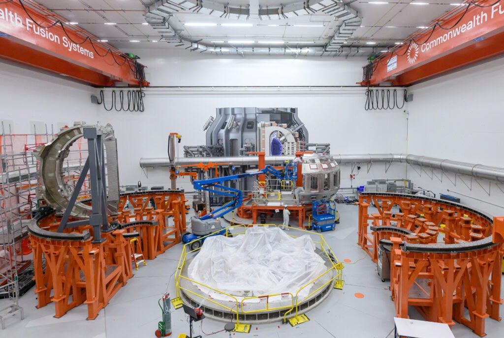

A Commonwealth Fusion Systems crew works on the first half of the vacuum vessel for the company’s SPARC fusion machine under construction at the group’s Devens, Massachusetts, headquarters. The vacuum vessel, a 48-ton steel component shaped like half a donut, arrived in October. The room also shows the circular base of the tokamak in the center of the room and on the orange stand at left, a mockup of a D-shaped toroidal field magnets. Source: Commonwealth Fusion Systems
