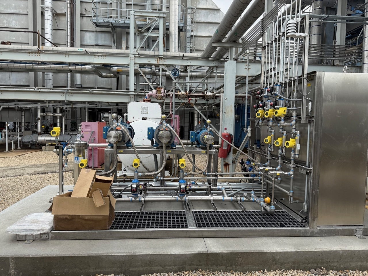

When Ironclad acquired the Morris plant, it decommissioned an aging and inefficient system that was supposed to operate like a gas turbine supercharger. It caused maintenance headaches, had a startup time of several hours, burned too much fuel, and worsened heat rate. Instead, Ironclad looked to wet compression (Figure 1) to provide an even better power boost but with improved efficiency and dramatically reduced ramp time.
gas-turbine-wet-compression
1. The wet compression and evaporative fogging skid installed at Morris Cogen. Courtesy: Mee Industries
The wet compression system has initially been installed on two of the gas turbines. They delivered more power than the old supercharger system with lower operating costs and a much faster start time. According to Deyoe, each turbine typically provides 38 MW. The addition of wet compression provides an additional 5 MW to 6 MW per unit with an improved turbine heat rate of about 400 Btu/kWh.
Once Ironclad completes installation of wet compression on the third turbine later in 2026, it is confident that it will gain enough extra power to be able to decommission its aging chillers, too. “Our old chillers are high maintenance, have a high parasitic load, and will eventually need a refrigerant upgrade,” said Deyoe. “We anticipate obtaining a big enough output boost from wet compression to offset the decommissioning of the chiller.”
Wet compression was installed in the early part of 2025. Ironclad wanted it in before the summer heat lowered turbine performance. From the point of placing the order, it took 24 weeks for the equipment to be delivered and installed. This enabled Morris Cogen to be ready for PJM’s hot summer and take full advantage of capacity payments. Representatives from Mee Industries came onsite to assist in installation.
“Our total spend on wet compression worked out to about $150 per kW, which is by far the cheapest way to add megawatts,” said Deyoe. “Whenever we buy a new plant, we now always consider adding wet compression as it is so cost effective.”

There have been a couple of lessons learned. During hot days, the plant noticed that the sun beating down on the fogging and wet compression skid was causing high-temperature alarms and preventing starts. The company erected a weather hood over the skid and insulated the water lines to keep the temperature down.
As fogging and wet compression need demineralized water, Ironclad initially tapped into an existing source at the plant. The water demand proved to be too much for the small diameter of the piping, and a booster pump had to be added to pull the volume required by the MeeFog systems and keep the pressure right.
Deyoe said that after a year of operation, everything is running as advertised and performance gains match expectations. The only maintenance action needed to date has been the replacement of a faulty solenoid. Once started, the system can be up and running within two minutes, he added.
