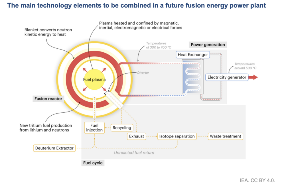

A fusion power plant integrates a plasma confinement system—heated by magnetic, inertial, electromagnetic, or electrical forces—with a blanket that converts neutron kinetic energy to heat, a divertor, a heat exchanger, and an electricity generator. A separate fuel cycle handles injection, recycling, isotope separation, and waste treatment, while new tritium fuel is produced from lithium and neutrons in the breeding blanket. Source: IEA, The State of Energy Innovation 2026. CC BY 4.0.
