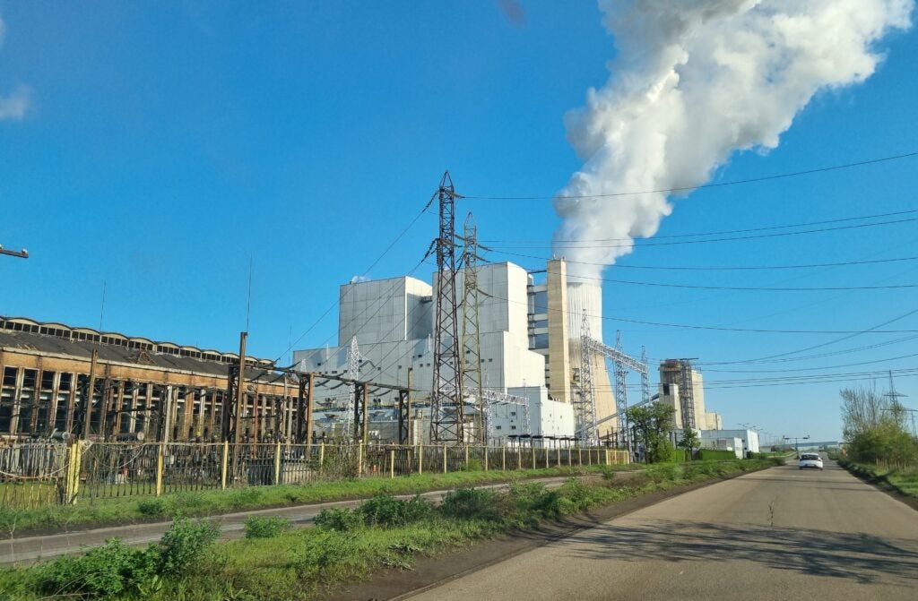

Aalborg CSP, headquartered in Denmark, has developed technology to enable the conversion of coal-fired power plants into thermal energy storage facilities. Source: Aalborg CSP

Aalborg CSP is, among others, collaborating with AES Bulgaria, the Bulgarian affiliate of the American energy group AES Corp., to explore the possibility of converting a large coal-fired power plant in Bulgaria. The power plant was built in 2010, but AES is considering converting it into an energy storage facility.
“Our state-of-the-art coal-fired power plant represents valuable infrastructure for the country and we are actively working on a solution that aligns with European and Bulgarian energy transition goals,” said Ivan Tzankov, president of AES Bulgaria. “This transformation would enable more renewable energy to be integrated into the market by storing surplus production and releasing it when demand is high. The conversion of our power facility into an advanced energy storage plant would reuse most of the exisiting infrastructure thereby securing the long-term viability of the asset while continuing to deliver reliable, clean energy to Bulgarian consumers for decades to come.”
