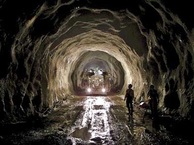

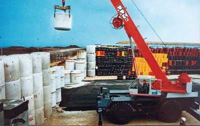

Although there are question marks surrounding the disposal of high-level radioactive waste, low- and intermediate-level waste issues are typically solved or much closer to solution. Sweden and Finland have crystalline rock cavern repositories in operation at depths of around 50 meters (about 150 feet). Hungary (Figure 1) is about to proceed with constructing a similar repository, but deeper, at around 270 meters (about 900 feet) (see "Nuclear waste disposal in Hungary"). There are also near-surface vault-type repositories operating in the UK, France, Spain, and other countries (Figure 2).
1. Bury it deep. The Bataapati site in southwest Hungary is designed for the disposal of low- to intermediate-level nuclear waste. Courtesy: Golder Associates
2. Packaged waste. Low- and intermediate-level radioactive waste at the La Manche site in Normandy, France is stored in sealed drums. The site will eventually be covered with concrete. Courtesy: Commissariat a L'Energie Atomique
