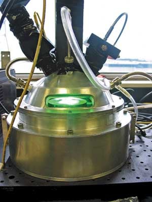

Recently, a new technology has been developed to assist power plant personnel in dealing with ash-related challenges. During the past two years, Lehigh University’s Energy Research Center (ERC) has worked with the Energy Research Co. (ERCo) of Staten Island, N.Y., in developing an optical technology that will allow power plant operators to make rapid adjustments to prevent boiler slagging and fouling problems (Figure 1). The project was funded by the U.S. Department of Energy’s (DOE’s) State Technologies Advancement Collaborative (STAC) program, which was managed by the New York State Energy Research and Development Authority (NYSERDA) and a Phase I Small Business Innovation Research program from the DOE’s National Energy Technology Laboratory.
1. Preventing sticky buildup. Laser-induced breakdown spectroscopy (LIBS) technology is designed to analyze coal composition and provide fusion temperature feedback to power plant staff who handle coal-fired boiler operations. Courtesy: Energy Research Center, Lehigh University
The ERC and ERCo have applied laser-induced breakdown spectroscopy (LIBS) technology to provide instant analysis of the elemental composition of the coal being burned and correlation of that analysis with the fusion temperature of the coal ash, which is affected by the concentration of the elemental coal ingredients.
