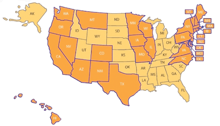

Renewable portfolio standards (RPSs) of various forms have been adopted by 28 states and the District of Columbia (Figure 1). Some set voluntary goals with long implementation schedules; others—like those of Texas, which call for 5,880 MW of renewable power sales by 2015—mandate both an absolute value and a near-term deadline. Several RPSs (like those of Illinois, Minnesota, and Oregon) aggressively target a penetration goal as high as 25% but allow plenty of time to meet it (2025, in all three cases).

1. In the majority. More than half of all U.S. states (darker) have enacted a renewable portfolio standard. Source: U.S. Department of Energy’s Energy Efficiency and Renewable Energy program

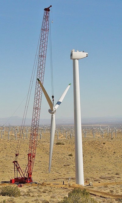

If you’re a utility resource planner, you have the usual two options—build or buy—for acquiring the wind capacity needed to help satisfy your RPS mandate. Each approach has pros and cons. Let’s start with the option of building your own wind farm.
2. Heavy lift. A crane lifts an entire blade assembly into place during construction of the 60-MW Oasis Wind Power Project. The project uses 50 Mitsubishi turbines rated at 1 MW each, and its output is sold to San Diego Gas & Electric Co. Courtesy: Mitsubishi Heavy Industries
