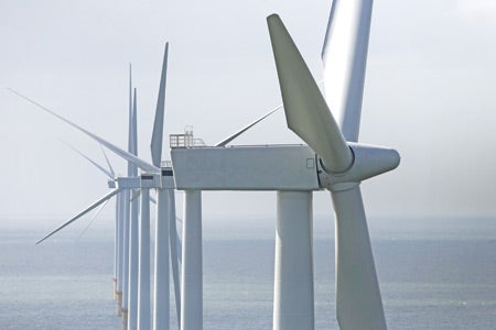

Denmark has 380 MW of offshore wind capacity—the most in the world. So it should come as no surprise that a Danish company, DONG Energy, is deeply involved in offshore wind project development both at home and in the UK. The company’s projects include construction of the 166-MW Nysted Offshore Wind Farm, located in the Baltic Sea offshore of Denmark, where 72 turbines generate 166 MW in what is the largest offshore wind farm in the world. DONG has several other projects under development, but its latest entry into the market is the Burbo Bank Offshore Wind Farm, which first produced power on July 21 and was commissioned on October 18 (Figure 1).
1. First choice. DONG Energy was first to deploy the Siemens Power Generation 3.6-MW offshore wind turbine, shown here at the Burbo Bank Offshore Wind Farm. Courtesy: Siemens Power Generation

The Burbo Bank installation is the first offshore project using the 3.6-MW Siemens Power Generation (SPG, www.powergeneration.siemens.com) SWT-3.6-107 turbines. SPG supplied and installed the 25 turbines on a 4-square-mile lease in the Burbo Flats in Liverpool Bay at the entrance to the River Mersey, approximately 4 miles from the Sefton coastline. The Burbo Banks, once feared by seamen for strong winds and shallow depths, is an excellent location for a wind farm for those very same reasons (see box). The 90-MW wind farm is operated by SeaScape Energy Ltd., a company owned by DONG.
Each wind turbine assembly consists of the turbine, blades, and nacelle; a support tower; and a foundation. Each turbine is configured with a 350-foot-diameter three-bladed rotor with blades 172 feet long (Figure 2). The rotor assembly is connected directly to the gearbox and generator contained in the nacelle and mounted on top of a 210-ft tower (Figure 3). Each tower supporting a turbine is anchored to the seabed by a foundation consisting of a single monopile structure over 16 ft in diameter and over 170 ft tall. The foundation is driven up to 80 ft into the seabed such that it extends 56 ft above mean sea level. The turbines are spaced between 1,750 and 2,400 ft apart.
