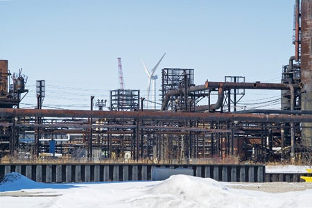

Construction of Steel Winds began in September 2006, six months after the EPA declared the site clean enough to be removed from its Superfund list. Today, the stark contrast of eight white turbines standing amid the remnants of abandoned factories juxtaposes the area’s past with its hopes for the future (Figure 1).
1. Rising from the slag. Eight Clipper Windpower Liberty turbines were built on the site of an abandoned steel mill on the shore of Lake Erie. Courtesy: Clipper Windpower Inc.
