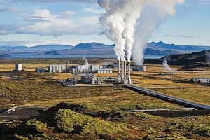

Iceland, for example, a country characterized by volcanoes and hot springs, uses geothermal energy to heat 90% of households but only taps 20% of its geothermal potential, and geothermal power only constitutes a quarter of its energy portfolio (Figure 7). Likewise, reservoirs in Italy, Turkey, France, Hungary, Poland, and Germany have massive but latent potential, the council says.
7.    Of ice and steam. Iceland, a country rich in volcanoes and hot springs, uses only 20% of its geothermal energy potential for heat and power, the National Energy Authority acknowledges. A quarter of the country’s power portfolio comes from geothermal energy, produced by five primary power plants. The 120-MW Nesjavellir power plant (shown here) in southwest Iceland is the largest of these. Plans to utilize the area for geothermal power were initialized in 1947, with research continuing until 1987. This plant started producing power in the early 1990s. Courtesy: Gretar Ívarsson
