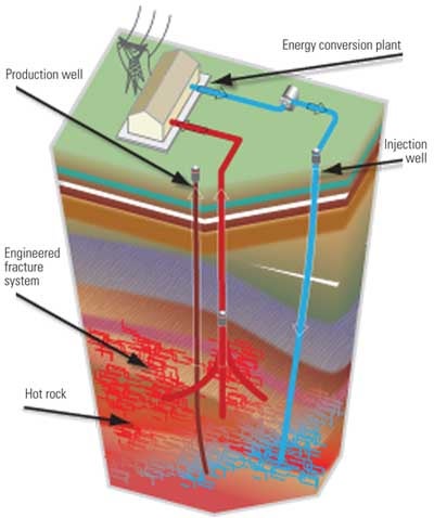

At the same time, fracking-related quake concerns are mounting in northern California, around The Geysers region, where start-up company AltaRock Energy is looking to tap geothermal energy in a demonstration of Engineered Geothermal Systems technology. The technology essentially pumps water into the earth, creating fractures in the hot dry rock (Figure 3). The water then flows into the fissures, creating a reservoir of very hot geothermal fluid that is continuously heated, and when it is returned to the surface, the pressure decrease produces steam, which is used to turn a turbine. That project has secured more than $36 million from the DOE and has the backing of several large venture capital firms.
3.     Cracks that run deep. Hydraulic fracturing—a process that involves drilling and then pumping fluid deep into a formation to generate fractures or cracks—has been thought to cause earthquakes, most recently in Cleburne, Texas, where fracturing, or “fracking,” is used to extract natural gas from shale. But Alta Rock’s geothermal demonstration plant, which uses Engineered Geothermal Systems technology (shown here) has also come under scrutiny because the project proposes fracturing hard rock more than 2 miles deep in an area overlying two fault lines. Courtesy: Department of Energy
