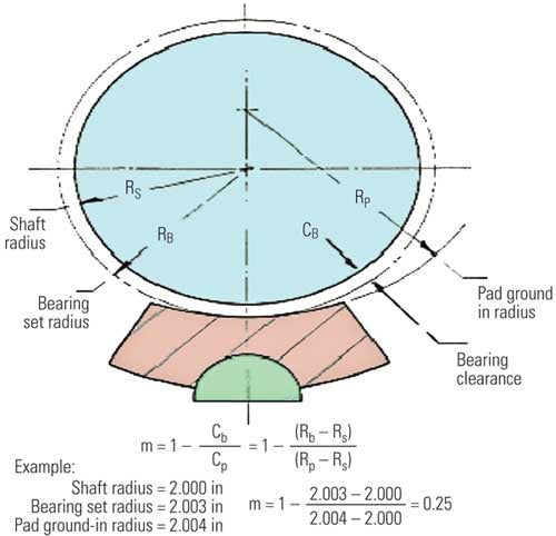

Modern units usually already employ tilt pad bearings. However, even with tilt pads, maintaining correct clearances and preloads is important to ensure sufficient damping. Adding tilt pad bearing preloads (Figure 1) normally addresses damping and subsynchronous stability concerns.
1.    Tilt pad bearing preload. Pad preload, m, is the amount of convergence and divergence that is built into the oil film through the pad geometry. If the pad surface is completely concentric with the shaft, the pad is said to have zero preload. Some shaft eccentricity is needed to create a converging oil film. By adding preload, the bearing load capacity and stiffness are usually increased, and the possibility of pad flutter is reduced because the top pads carry more load. Preload is accomplished by boring the arcs of the pads to a larger diameter than the clearance diameter. Typical preload values range from 0.0 to 0.5, with the most common being about 0.3. Source: TG Advisers Inc.
