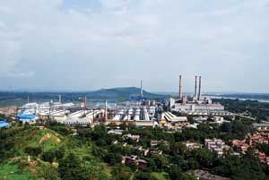

In 1994, INDAL established its first coal-fired power generation system, rated at 67.5 MW, to provide an uninterruptible power supply to its adjoining aluminum smelting operation (Figure 1). Fortuitously, one of Asia’s largest coal deposits is located nearby, making the fuel choice simple. In 1999, Aditya Birla Group took over INDAL from the Aluminum Company of Canada and merged it with its flagship unit, Hindalco, a year later.
1.    Reliable electricity needed for growth. Hirakud Power is a “captive power plant” that supplies all the electricity needed by Hindalco’s aluminum-smelting operation next door. The plant was built and expanded when government-run hydroelectric plants could not supply enough reliable and reasonably priced electricity to support the growing aluminum-smelting plant. The coal mine that supplies the plant’s fuel is located nearby. Courtesy: Hirakud Power
