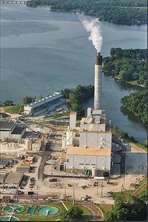

1.    First among equals. City Water, Light & Power of the City of Springfield is completing commissioning of its new 200-MW Dallman Unit 4. The new plant fires Illinois coal and promises to provide a reliable and economic source of electricity for many years to come. Courtesy: CWLP. Photo by Terry Farmer Photography

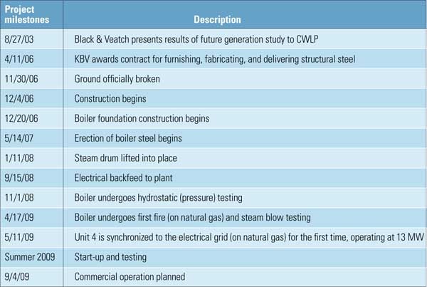

The $515 million project is the most expensive project ever built by Springfield. What’s more, it was completed with minimal cost increases — an impressive feat, especially in today’s construction market. The plant also is entering commercial service approximately six months ahead of schedule (Table 1) and under budget, saving Springfield even more valuable cash just when other cities are looking for ways to increase revenues. CWLP’s general manager, Todd Renfrow, noted that the community is "very proud to soon be the owner of one of the cleanest and most advanced coal-fired power plants in the nation. The execution of the project with little cost overrun and being so far ahead of schedule has raised the bar in power plant design and construction."
Table 1.    Actual project schedule. Source: CWLP
