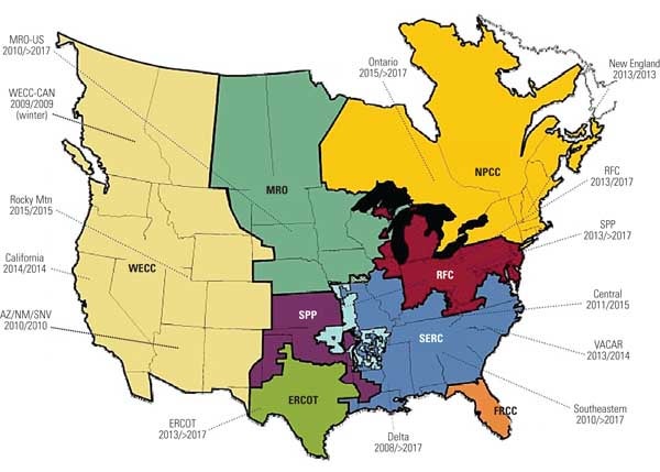

In the meantime, the power industry is faced with some tough challenges. First and foremost is deciding what kind of generation to build, when to build it, and where. Although the North American Electric Reliability Corp. (NERC) in its "2008 Long-Term Reliability Assessment, 2008 – 2017" report says that it sees a 4.2% improvement in capacity margins over its assessment in the previous year’s report, new resources are still critically required in some areas (Figure 1).
1. Scraping by. Acceptable electricity capacity levels will be available in most NERC regions of the U.S. for the next few years. The dates shown represent the date when net capacity resources drop below the NERC reference margin level with existing resources and when they are adjusted based on potential resources. Source: NERC
Net capacity resources are forecast to drop below NERC reference margins in 2010 in Arizona, New Mexico, and southern Nevada — a one-year reprieve over the prior forecast. Other areas in the U.S. are expected to hit capacity margin limits by 2013. Furthermore, critical transmission links are required to interconnect new sources of power with the loads, especially with respect to the major renewable resources: wind, geothermal, and solar. This, on top of the need to replace aging, less-efficient and less – environmentally clean older plants, will create considerable pressure for utilities to build... well, something.
