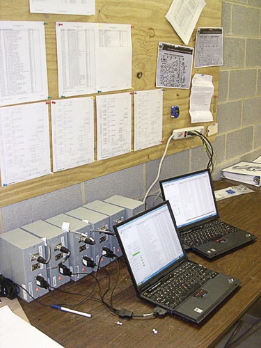

1. Trading spaces. This is a typical setup of data acquisition computers used during a plant performance test. Courtesy: McHale & Associates

Tests are normally conducted at full-load operation for a predetermined period of time. The test team collects the necessary data and runs them through the facility correction model to obtain preliminary results. Usually within a day, a preliminary test report or letter is generated to allow the owner to declare "substantial completion" and commence commercial operation. The results for fuel sample analysis (and/or ash samples) are usually available within a couple of weeks, allowing the final customer report to be finished and submitted.
