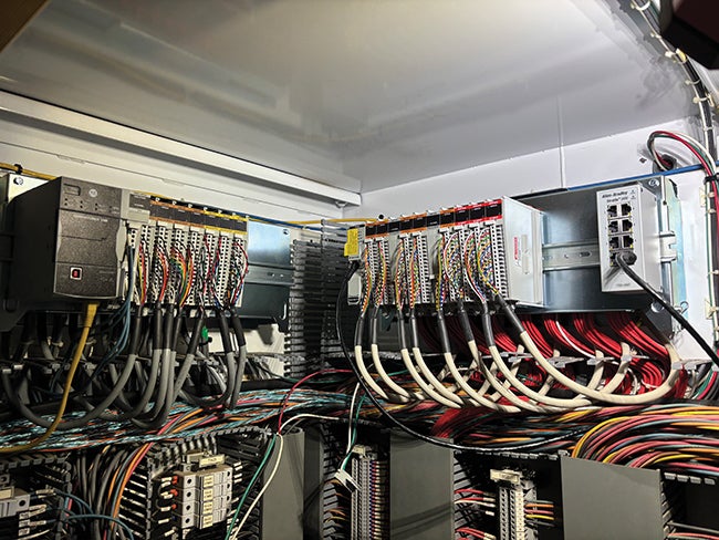

1. Control panel upgrades at a power generation facility. Courtesy: Aquatech
When correctly implemented, each migration is engineered to preserve existing process functionality while enhancing system performance, reliability, and expandability. Upgrades (Figure 1) can be accomplished during outage windows. Partners with expertise in both process and controls should be selected to ensure a smooth startup and system transition following implementation. In addition, process expertise can be leveraged to optimize software and control logic programming.

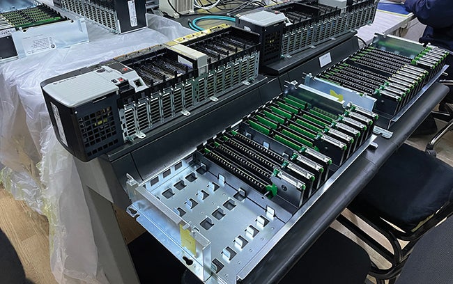

2. System upgrades at gas processing facility. Courtesy: Aquatech
Gas Processing Facility. A legacy PLC-5 system was upgraded to ControlLogix 5580 (Figure 2) alongside a full SCADA modernization using Aveva Plant SCADA. The project included replacing aging HMI infrastructure with redundant storage systems to improve resilience. Full system cutover was completed in just eight days, reducing long-term risk associated with obsolete hardware while improving visibility and control.
