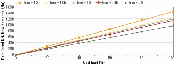

So how is a trim controller different from a conventional controller? The reason I use the term "trim controller" is because the output from a controller, which ranges from 0% to 100%, then enters a function generator to scale the output of the controller. For example, perhaps 50% = 1.0, 0% equals < 1.0 (0.8 is typical), and 100% equals > 1.0 (1.2 is typical). The output of this function is then multiplied against some other variable. In airflow control, the O2 trim is usually multiplied against the airflow. The Btu correction is applied against measured coal flow. In NOx control, the outlet NOx trim is multiplied against the calculated NH3 requirement. In this example, the result is a family of curves of various slopes (Figure 2).
2. Effect of trim on calculated NH3 demand. Trim controllers are best used in steady state processes with fixed input variables. Coal combustion processes, in contrast, are complex, continuously changing, and difficult to predict. Source: Tim Leopold
The Effect of Trim on Calculated NH3 Demand
The impact of using trim control can be profound and explains why it is only used in specific applications in conventional boiler controls. For a given change in controller output, we expect to see a corresponding response. However, in Figure 2, we are actually adding an element of variability to the controls, in that for a given controller output we are changing the slope of the demand. This means that we assume a family of NH3 flow demand functions, depending on what has just occurred with the outlet NOx. This is why O2 trim and Btu compensation are, or should be, primarily integral only, and slow integrals at that. That is also why trim control does not do well in a load change or a boiler excursion.
Please bear in mind that the functions in Figure 2 are a somewhat simplistic representation of the complex calculation of the NH3 flow required for NOx reduction. The functions are not usually straight lines across the entire boiler load range. The calculation reacts to certain differing conditions in the boiler, such as fuel flow, O2 content, NH3 concentration, and possibly other measured variables.

This means that if these boiler conditions change, then the calculated value changes. However, depending on the output of the trim controller, the amplitude of the reaction will vary because the calculation can only look at a few, finite number of measured variables and not these unmeasurable factors inherent in the boiler environment.

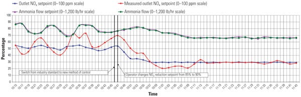

Figure 4 shows the data from a test of the new approach to controlling outlet NOx and NH3 flow just described. The logic outlined in Figure 3 was implemented at the Gainesville Regional Utilities’ Deerhaven plant. However, the standard industry approach was not eliminated (because of warranty issues); instead, the new NOx control approach was implemented with a slow transfer switch to allow us to go from one scheme to the other to compare the system’s response.
First of all, the calculated ammonia requirement devolves to the line trim = 1.0. Therefore, the reaction to changes in the boiler conditions as seen by the controller is always the same. Again, this is important in controls. We are now able to shape the effect of the calculated NH3 demand (the feedforward) by use of a function generator and maybe a derivative kick. The outlet NOx controller in this approach is stronger, more dynamic, and more robust. The end result is a control loop that can be better tuned to control the outlet NOx and the injected ammonia.
In Figure 4, the NOx trim controller transforms to the outlet NOx controller. The transfer is begun at the time shown by the first vertical line. Then, fortunately for the sake of this illustration, the operators, unbeknownst to me, increased the reduction requirement from 85% to 90% (second vertical line). The new controls were tuned with only preliminary estimates, yet it can be seen that control of the outlet NOx quickly becomes more stable.
4. Real-world testing. The new control strategy was implemented at Gainesville Regional Utilities’ Deerhaven plant with excellent results: The plant can now control outlet NOx to within 2% of setpoint from 40% to 100% of full load, compared to the previous 5% to 6% using the old control logic approach. Source: Tim Leopold
After seeing the results of the new control loop’s response to load and coal changes, Babcock Power eliminated the industry standard solution and has implemented the changes suggested above. The Deerhaven plant has exercised this control loop from 40% to 100% load with less than 2% NOx outlet swings. This is considerably better than the 5% to 6% NOx outlet swings with the old logic standard approach.
