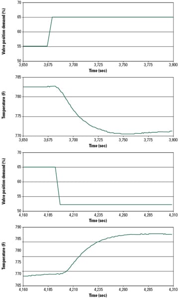

After the new thermowells were installed and the unit was back online, open-loop step response tests were performed on the superheater spray valves. These tests were done by placing the steam temperature controls in manual mode and manually moving the spray valve quickly from one position to another. The desuperheater outlet temperature was recorded and analyzed to determine the response characteristics, in this case three parameters: gain, time constant, and dead time.
For the first test shown in Figure 2, the time constant was 17.4 seconds and the dead time was 9.8 seconds. For the second test, the time constant was 20.2 seconds and the dead time was 9.8 seconds. These tests were done at approximately 100 MW. The times represent the response from the valve position demand signal to the measured temperature, so the response of the valve actuator is included in this response time. A similar test on the old thermowell produced a time constant of approximately 70 seconds, so there was a dramatic reduction with the new thermowell. Other tests with the new thermowell were done at 270 MW, full load, and the time constant for those tests averaged 16 seconds with an average dead time of 3.8 seconds.
2. Test responses. Step responses of desuperheater outlet temperature to a change in spray valve position are shown. The response to a step change open is shown in the top two graphs, and a step change close is shown in the bottom two. Source: Southern Company

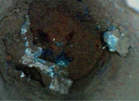

After the old thermowells were removed, the bores of the wells were inspected using a small borescope. Considerable debris was found in the bore of one thermowell, and some of it appeared to be metallic (Figure 3). Some of this debris may have fallen into the thermowell when the thermocouple was removed during removal of the thermowell. This discovery required determining the nature of the debris and what impact it might have had on the slow response time observed with the old thermowell.
3. Bore debris. This debris was found in the bottom of a bore in one of the old (removed) thermowells. Courtesy: Southern Company
A plan was developed to test the old thermowell using the same temperature calibration facility described in the earlier article. Tests were to be conducted first in the as-found condition and later with the bore cleared of all debris. Unfortunately, the thermowell with the most debris was too badly damaged during removal to be tested in the lab, so the thermowell with less debris was tested.

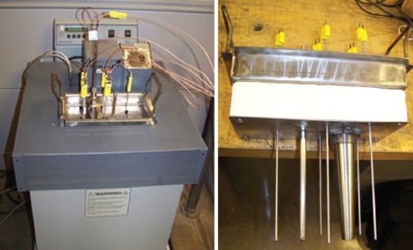

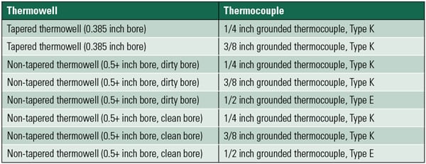

Because tests would be extremely difficult to perform in the steam line of interest, they were conducted in a lab setting with a molten salt bath at 350F (Figure 4). For each test, a room temperature thermowell was submerged in the molten salt and the temperature response was recorded. The most recent test focused on assessing the performance of the nontapered thermowell and on repeating a subset of the first round of tests to confirm previous results (Table 1).
4. Molten salt test. Field-testing was impractical, so a laboratory setting with a molten salt bath at 350F was used to assess performance of the nontapered thermowell and to confirm earlier test results. The Hart Scientific heat bath with thermocouple tray used for testing thermocouple response times (L) and the underside of the tray holding test thermowell and reference thermocouples (R) are shown. Source: Southern Company
Table 1. Tests conducted in the thermal bath in the second round of testing. Source: Southern Company

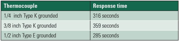

The “submersion test” results for the nontapered, dirty-bore thermowell are shown in Figure 5. For these three tests, the response times (time to reach 63% of the final value) were approximately those shown in Table 2.
5. Submersion test results. The results of a submersion test for a straight shank, dirty-bore thermowell with various size thermocouples is illustrated. The system response is the time required to reach 63% fo the final value. Response curves for each of the tests described in Table 1 were developed. Source: Southern Company
5. Submersion test results. The results of a submersion test for a straight shank, dirty-bore thermowell with various size thermocouples is illustrated. The system response is the time required to reach 63% of the final value. Response curves for each of the tests described in Table 1 were developed. Source: Southern Company
As expected, the response was faster for the ½ inch thermocouple than the other two (1/4 inch and 3/8 inch), which confirms the need to match thermocouple diameter to thermowell bore diameter to obtain the fastest response time. Of course, these results were conducted in a salt bath and not steam conditions. For that application, the thermowell outside surface convective heat transfer coefficient is approximately three times that observed in the salt bath. When this increase in heat transfer coefficient is considered, the projected response time in the steam line is approximately 75 seconds and compares very favorably to the 70 seconds observed during plant testing.

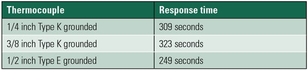

Next, the bore of the nontapered thermowell was cleaned and the submersion tests were repeated. For these three tests, the response times (time to reach 63% of the final value) were approximately those shown in Table 3.
Table 3. Submersion test results after the nontapered thermowell bore was cleaned. Source: Southern Company
Note that the response times for the cleaned bore are greater than for the dirty bore (Figures 4 and 5). This result is counterintuitive but may be due to surface imperfections with the dirty bore that created greater contact area between the thermowell and the thermocouples, thus improving that heat transfer coefficient, or to unknown and uncontrolled factors in the test method.
As shown, cleaning the thermowell had very little impact on the response time of the 1/4-inch thermocouple, likely because the response time of this thermocouple is largely driven by the relatively small point of contact area between the thermowell and thermocouple (arguably, just at the tip). For the 1/2-inch thermocouple, the response time with the dirty bore was slightly faster (by approximately 15%) than that observed with the clean bore. Again, this may be attributable to greater surface contact area provided by the dirty bore.
