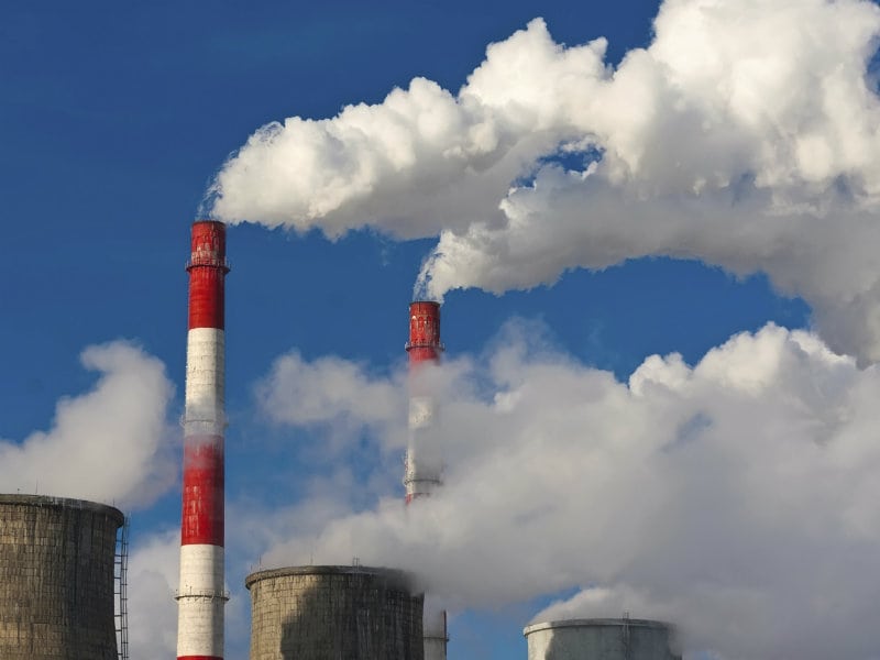

Swedish power company Vattenfall is testing a technology that stores energy in salt, with a goal of proving whether the process would be useful for storage of renewable energy such as from wind and solar farms. The pilot project, commissioned April 11 at the Reuter thermal power plant in Berlin (Figure 1), is being conducted with Swedish company SaltX Technology, which has said its system has been proven to store up to 10 times more energy in salt than in water, and for longer periods. SaltX’s technology uses salt crystals coated in a nano material, which is heated with electricity, with the heat released when the crystals are discharged.
1. Vattenfall is rebuilding the Reuter thermal power plant, preparing to retire its coal-fired unit and adding a power-to-heat facility. Courtesy: Vattenfall
