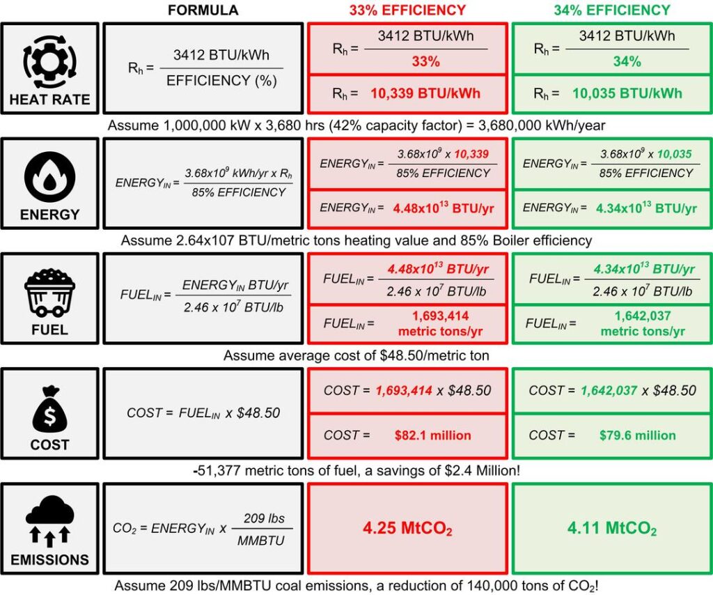

Improving steam turbine efficiency has a direct impact on the amount of fuel utilized in a facility’s cycle, thereby reducing emissions and saving the operator money. Depending on the plant design and operating temperatures, a turbine efficiency increase of anywhere from 2% to 3% can result in an increase of 1% in plant efficiency. The International Energy Agency suggests a 1% efficiency improvement can reduce CO2 emissions by 2% to 3%. Consider global coal emissions of 15 gigatons of CO2 (GtCO2) in 2023. Improving average plant efficiency by 1% could result in an emissions reduction of up to 450 million metric tons (mt).
In addition to reduced emissions, the reduction in operating expenses (OpEx) can also be significant. Consider a 1% efficiency increase at a 1,000-MW coal plant. Increasing efficiency from 33% to 34% improves heat rate by about 3%. With a capacity factor of 42%, for example, the resulting reduction in coal consumption would be approximately 51,000 mt/year. At an average cost of $48.50/mt, the annual fuel savings would be $2.5 million, and at 209 lbs CO2/MMBtu, the emissions savings would be 140,000 tons of CO2 (FIgure 1).
1. Small increases in efficiency can have large impacts in return on investment and emissions payback time. Courtesy: Fossil Consulting Services
For a similar natural gas–fired boiler, the fuel reduction could be as much as 510 million cubic feet (MMcf) per year. At an average price of $4.35/Mcf, the fuel savings could be as high as $2.2 million per year (assuming a 20% capacity factor).

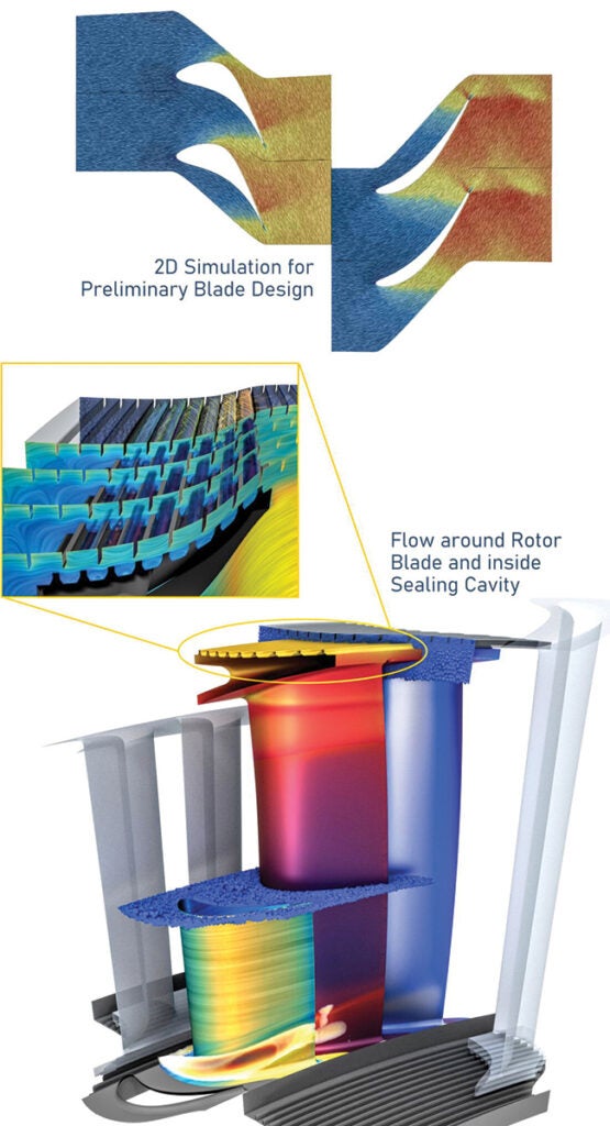

Companies like GE Vernova, Siemens Energy, and Mitsubishi Power have developed design improvements in blade aerodynamics, cooling, inter-stage leakage reduction, and moisture control to improve overall performance of large turbines, for both new and retrofit installations. Companies like German engineering firm B&B-AGEMA continue to apply computational fluid dynamics (CFD) and finite element analysis (FEA) to existing turbines to develop design improvements in flow stability, vibration, mechanical and thermal stress, and sealing. Utilizing advanced software, such as B&B-AGEMA’s Simcenter STAR-CCM+, high resolution simulations of multi-stage flow profiles have become standard (Figure 2).
2. B&B-AGEMA’s Simcenter STAR-CCM+ software allows computational fluid dynamics (CFD) analysis of turbine stages, providing high-resolution, multi-stage flow simulations to be utilized as standard practice. Courtesy: B&B-AGEMA
Improvements in stage design, specifically in the loss mechanisms of leakage flow, have been proposed in multiple research documents. One notable concept focused on installation of “bladelets” into the leakage flow path at the rotor shroud to redirect leakage flow back into the main steam flow path at the same angle. Another design enhancement included the introduction of a “swirl breaker,” which in test models showed improved efficiency at each stage by reducing the mixing loss of rotor shroud leakage flow and mainstream flow.

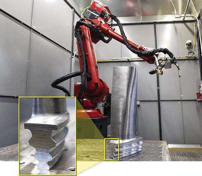

In addition, advancements in manufacturing can result in reduced repair and manufacture timelines, even with complex designs. In 2023, Oak Ridge National Laboratory and Siemens Technology became the first to “3D print” a utility-scale steam turbine blade using a process called wire arc additive manufacturing. An electric arc is used to melt wire in a process controlled by a robotic arm (Figure 3). Once printed, the part can be machined to final tolerances. Originally pursued to address supply chain delays in parts casted overseas, this process has the potential to improve production and repair capabilities. 3D printing could prove invaluable to the retrofitting process, combining advanced design techniques with turbine specific manufacturing to improve retrofit capabilities at reduced cost and timelines.
3. 3D-printed steam turbine blade. Courtesy: Carlos Jones/Oak Ridge National Laboratory, U.S. Department of Energy

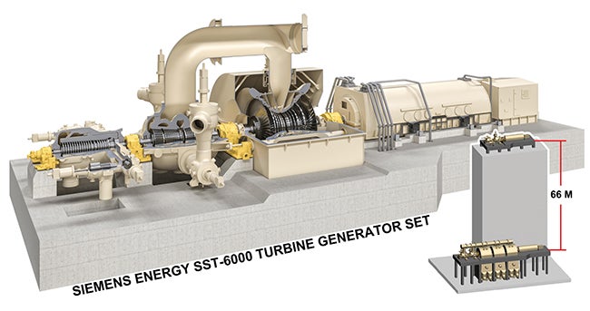

Facilities like Pingshan II in China, in operation since 2022, (49% unit efficiency, operating pressure 4,700 psia) utilize these advanced materials and advanced ultrasupercritical (A-USC) steam turbine designs. Pingshan II was the first implementation of a “split train” turbine, referred to as an elevated turbine generator (TG). The cross-compound turbine set utilizes Siemens Energy’s SST-6000 turbine design, similar to that shown in Figure 4. The design consists of an HP and IP1 turbine and generator located at an elevation near the boiler steam outlet, and an IP2 with three LP turbines (LP1–LP3) and associated generator set located at the “ground” level. The elevated HP turbine reduces heat losses to the HP turbine. However, there is a trade-off in the increased length of secondary reheat piping that must be accounted for.
4. Pingshan II consists of dual trains installed at different elevations (bottom right). The upper train consists of a high-pressure (HP) and intermediate pressure (IP) turbine coupled to a generator, while the lower train consists of an IP and three low-pressure (LP) turbines coupled to a second generator. Courtesy: Siemens Energy
