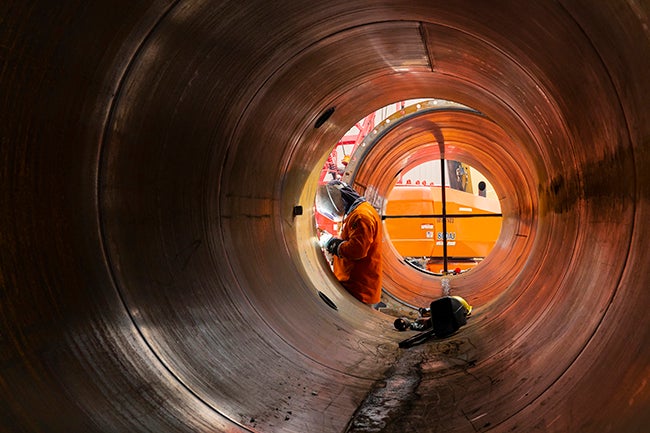

1. A skilled labor crunch is challenging power project development across nearly every region of the world. Courtesy: Burns & McDonnell

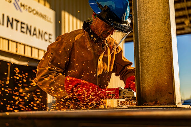

Proactive EPCs are responding with transformational workforce development initiatives. Burns & McDonnell, for example, launched a 14,000-square-foot Construction Academy in Pearland, Texas, earlier this year, designed as both a recruitment hub and skills development center. The firm is also deploying mobile training units that bring in-the-field knowledge assessments directly to project sites, reducing onboarding time and ensuring a supply of skilled artisans ready to work. Addressing the labor shortage requires new, scalable approaches, said Jeff Rashall, vice president of Burns & McDonnell’s Construction Group. The company’s initiatives aim to create a self-sustaining pipeline of talent, emphasizing safety, productivity, and rapid upskilling, he said (Figure 3).
3. Burns & McDonnell opened a 14,000-square-foot Construction Academy in Pearland, Texas, in 2025, offering knowledge assessments and hands-on training. A permanent skills facility simulating job site conditions will open in 2026. The academy qualifies craft workers through online knowledge assessment followed by hands-on evaluation—part of Burns & McDonnell’s effort to address labor constraints and develop next-generation talent at scale. Courtesy: Burns & McDonnell
