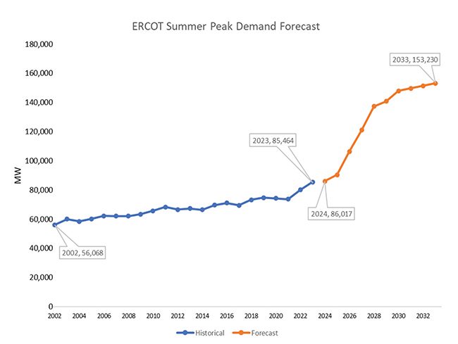

1. The Electric Reliability Council of Texas’s (ERCOT’s) long-term load forecast, an hourly forecast for the next 10 years, anticipates a dramatic surge for its summer peak over the next seven years. Courtesy: ERCOT
“Supply is coming off of the system, and new supply additions are not keeping pace,” Asim Haque, PJM’s senior vice president of Governmental and Member Services, recently told a U.S. House subcommittee. At the Electric Reliability Council of Texas (ERCOT), long-term load forecasts project a similar summer peak surge of 67 GW by 2032, driven by a load increase of 148 GW by 2030 from cryptomining, data centers, hydrogen production, and industrial needs, including from oil and gas (Figure 1).
