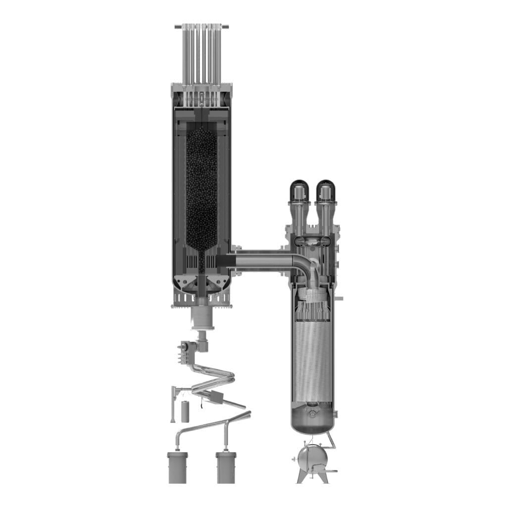

Energy Northwest said it has been investigating numerous emerging nuclear energy technologies for more than two years, arriving at the determination X-energy’s advanced SMR—known as the Xe-100—is “the design best tailored to the region’s specific needs.” In July 2023, Energy Northwest and X-energy announced the signing of a joint development agreement for up to 12 Xe-100 advanced SMRs in central Washington capable of generating up to 960 MW. Energy Northwest expects to bring the first Xe-100 module (Figure 2) online by 2030.
2. Xe-100 reactor. Courtesy: X-energy
Each Xe-100 module can provide 80 MW of full-time electricity or 200 MW of high-temperature steam. X-energy says its innovative and simplified modular design is road-shippable and intended to drive scalability, accelerate construction timelines, and create more predictable and manageable construction costs.
“The Xe-100 high-temperature gas-cooled reactor technology can power a broad range of applications through its high-temperature steam output that can address the needs of large regional electricity providers as well as industrial manufacturing systems,” the company said. In May 2023, Dow Inc. selected its UCC Seadrift Operations manufacturing site on the Texas Gulf Coast for X-energy’s first deployment of the Xe-100 as part of the U.S. Department of Energy’s (DOE’s) Advanced Reactor Demonstration Program (ARDP). X-energy was awarded $1.2 billion from the DOE in 2021 under the ARDP in federal cost-shared funding to develop, license, build, and demonstrate an operational advanced reactor and fuel fabrication facility by the end of the decade.
