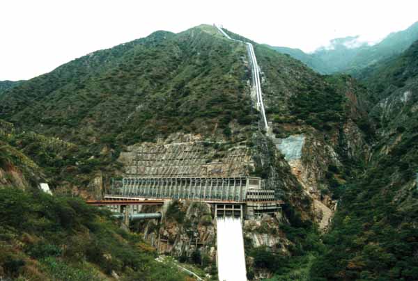

1.    Mantaro, owned by state company Electroperú, is the country’s largest power generation complex, with a total of 1 GW. Brazilian investors, with the support of the Peruvian and Brazilian governments, are now evaluating large hydro projects in the Amazon jungle for a total of approximately 6 GW.
