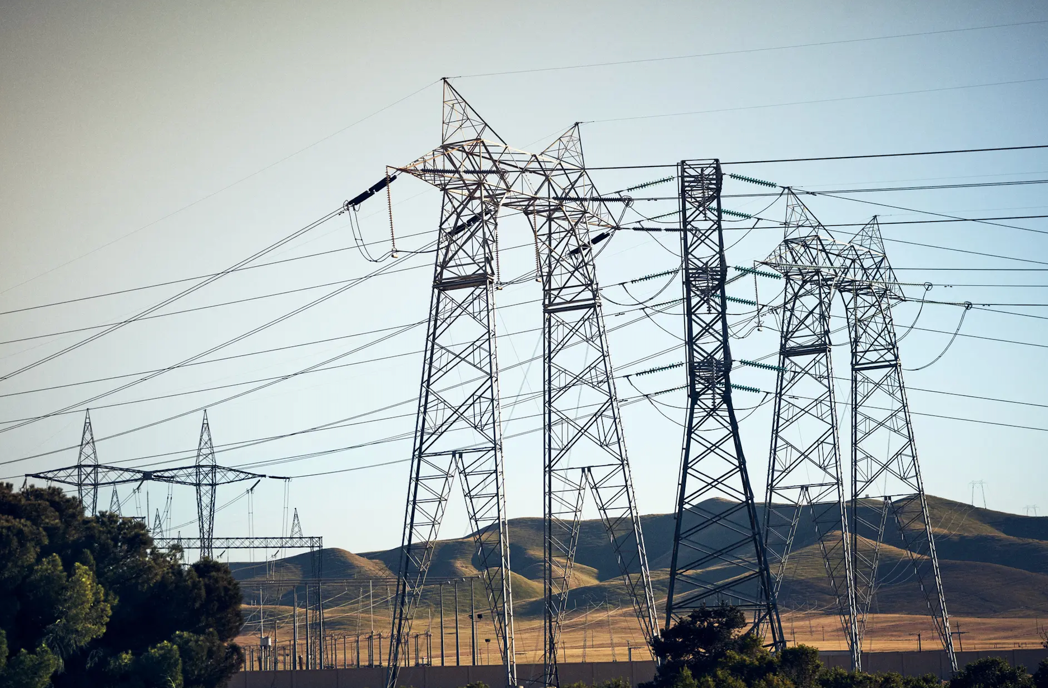

1. The use of Universal Damping STATCOM technology, which can absorb energy from oscillations along transmission lines, can help stabilize the power grid and improve power delivery reliability. Source: Ramboll
