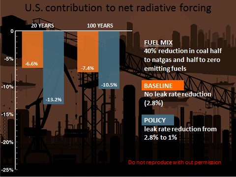

The systemic leakage rate will determine whether or not natural gas provides a net climate benefit, with implications for assessing the relative environmental benefits of fuel switching from coal or diesel to natural gas (Figure 1).
1. This model disaggregates the leak rate of 2.8% as follows: 2.0% is leakage from well to city gate (this applies to power plants); 2.3% is leakage from well-to-end user (applies to homes and industrial users); the additional 0.5% accounts for leakage from natural gas vehicle refueling and use. Source: EDF
As Figure 1 illustrates, lowering the methane leakage and venting rate to 1% of total production would double the climate benefit derived from coal-to-natural gas fuel switching over the next 20 years—producing as much climate benefit in that time as closing one-third of the nation’s coal plants. (This assumes that 1% is the amount of natural gas produced at well sites lost to the atmosphere, in comparison to a baseline of 2.8%, and that the retired coal-fired generation is replaced with equal parts high efficiency natural gas fired generation and zero-emissions electric generation, such as renewables.
