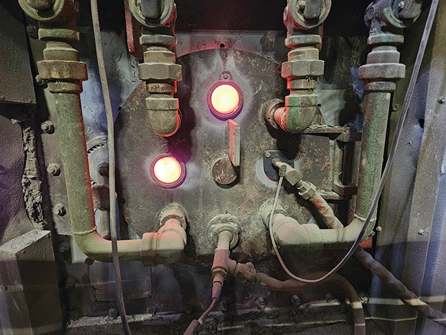

1. A Preferred Utilities Spec Com burner delivering reliable performance at a waste-to-energy (WTE) facility in the southeastern U.S. Courtesy: Preferred Utilities Manufacturing Corp.
As these plants age, retrofitting the startup burners (Figure 1), combustion controls, forced draft (FD) fans, and fuel trains is increasingly important. Modernization not only improves reliability and combustion performance but also ensures compliance with current safety codes and standards, including National Fire Protection Association (NFPA) requirements. That’s where retrofits can make a substantial impact.

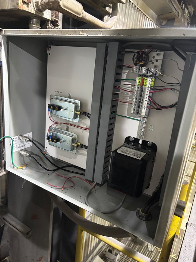

WTE plants are most efficient and reliable when the burners and controls (Figure 2) are integrated as part of a coordinated system. In many plants, burner controls only manage the burner itself. Modern facilities must be able to pull inputs from their system operations and use those boiler/furnace parameters to recommend burner adjustments for better, more efficient firing.
2. Preferred Utilities controls—managing combustion output and improving efficiency. Courtesy: Preferred Utilities Manufacturing Corp.
Integrated systems provide smarter and more adaptive combustion while reducing failure points across the entire operation. They allow operators to control the burners from a main control room while still supporting local operation at the burner level when needed. They enable coordination across the entire boiler system, providing operators with the most complete firing recommendations to maintain a stable operating environment. And they reduce manual intervention, leading to fewer failure points and higher efficiency.

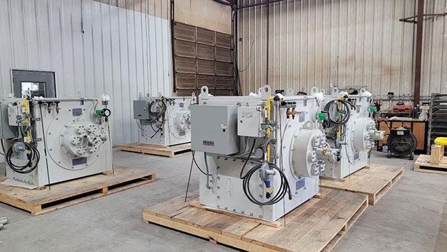

3. Four Preferred Utilities Spec Com burners/windboxes for a WTE plant. Courtesy: Preferred Utilities Manufacturing Corp.
Preferred Utilities helps WTE facilities modernize aging boiler systems through targeted burner (Figure 3) and control retrofits. Preferred can support the full range of upgrades discussed in this article, creating integrated systems and installing targeted upgrades to burners and burner management systems, flame detection, airflow control, and much more. ■
