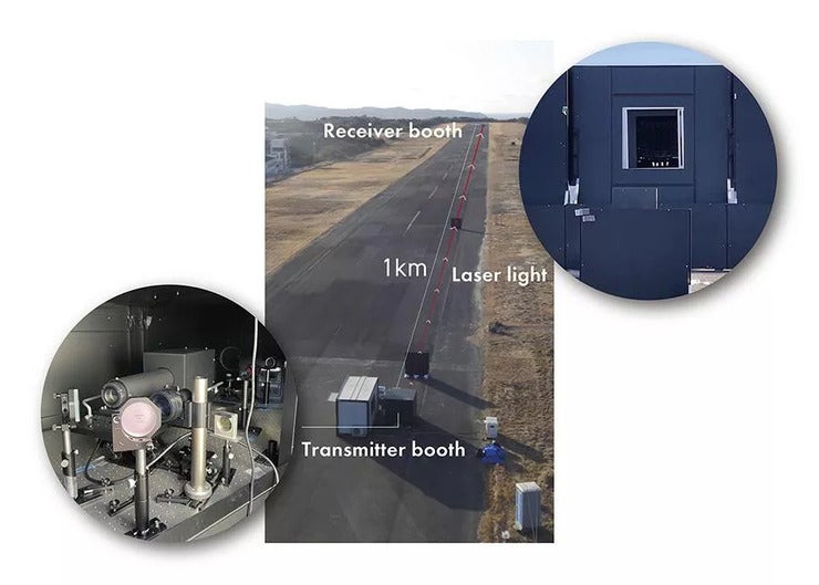

From January to February 2025, MHI conducted an optical wireless power transmission experiment on a runway at the Nanki-Shirahama Airport in Shirahama Town, Nishimuro District, Wakayama Prefecture (Figure 2). A transmission booth equipped with an optical system for emitting the laser beam was installed at one end of the runway, and a reception booth containing a light-receiving panel was placed one kilometer away.
2. An optical wireless power transmission experiment was conducted on a runway at the Nanki-Shirahama Airport. Courtesy: MHI
During transmission, the optical axis of the laser was set at a low height of approximately one meter above the ground and aligned horizontally. As a result, the beam was strongly affected by ground heating and wind, and the experiment was conducted under conditions with strong atmospheric turbulence.

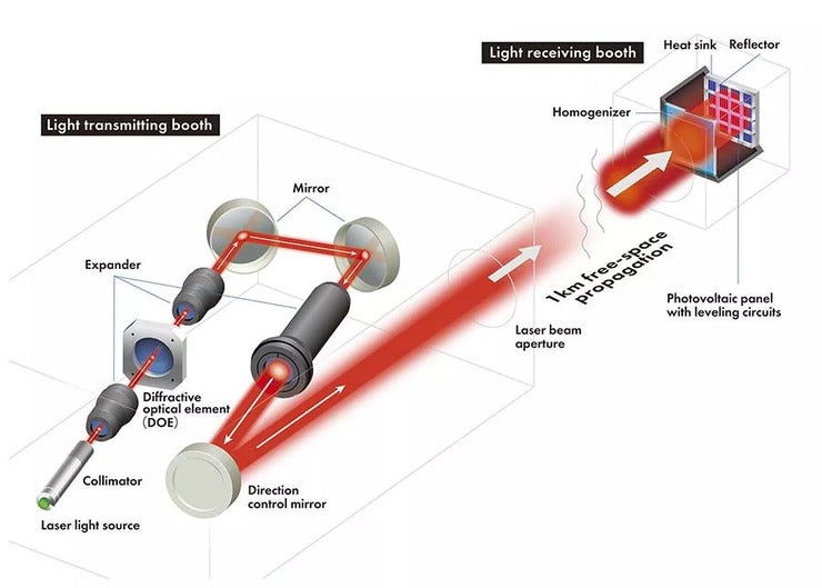

Inside the transmission booth, a laser beam with an optical power of 1,035 W was generated. Using a diffractive optical element (DOE), the beam was shaped to create a uniform intensity distribution at a distance of one kilometer. In addition, a beam steering mirror was used to precisely direct the shaped beam toward the receiving panel. The beam exited through the aperture of the transmission booth and propagated across one kilometer of open space, ultimately reaching the reception booth.
During propagation, atmospheric turbulence caused fluctuations in the beam’s intensity, creating hot spots. These were diffused by a homogenizer in the reception booth, resulting in a uniform beam being irradiated onto the receiving panel. The laser beam was then efficiently converted into electrical power (Figure 3). A silicon-based photoelectric conversion element was adopted for the receiving panel, taking into account both cost and availability.
3. A schematic diagram of the experimental system. Courtesy: MHI

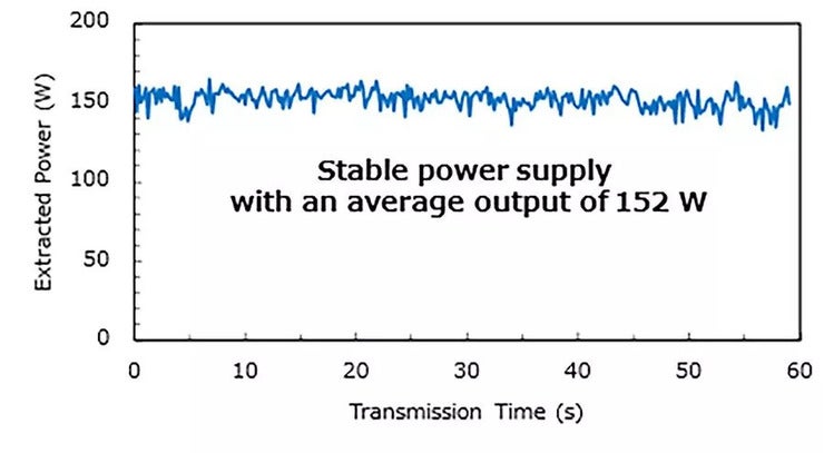

In this experiment, the average electrical power extracted from the receiving panel was 152 W (Figure 4), corresponding to a wireless power transmission efficiency of 15%, defined as the ratio of received electrical power to transmitted optical power. This result marks the world’s highest optical wireless power transmission efficiency ever demonstrated using a silicon-based photoelectric conversion element under conditions of strong atmospheric turbulence. Furthermore, continuous power delivery was successfully maintained for 30 minutes, confirming the feasibility of long-duration power transmission using this technology.
4. Power from the light-receiving panel. Courtesy: MHI

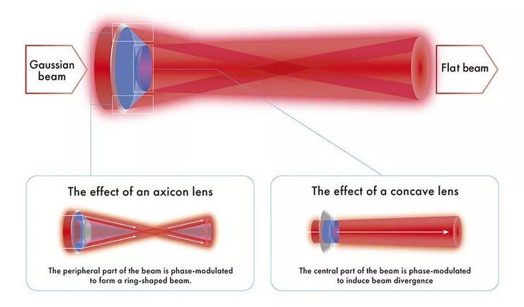

Long-Distance Flat Beam Shaping Technology. To improve photoelectric conversion efficiency, it is necessary to make the intensity distribution of the beam incident on the photoelectric conversion element uniform. In this study, MHI proposed a beam shaping method that enables intensity uniformity after long-distance propagation. In this approach, the outer part of the beam is transformed into a ring-shaped pattern using the effect of an axicon lens. The central part of the beam is phase-modulated to expand through the effect of a concave lens. As the beam propagates, the ring-shaped beam and the expanded central beam gradually overlap, resulting in a uniform intensity distribution at the target location, as shown in Figure 5.
5. Image of beam shaping. Courtesy: MHI
For the experiment, MHI optimized the beam design to achieve the desired intensity profile at a distance of one kilometer. The beam shaping was implemented using a diffractive optical element, which improved the uniformity of the beam intensity at the target position located one kilometer away.

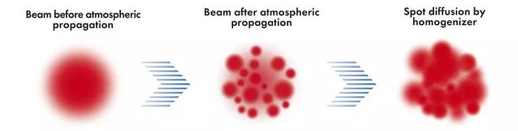

Output Current Leveling Technology. As the laser beam propagates through the atmosphere, it is affected by atmospheric turbulence, which disturbs the intensity distribution. Although the flat-beam shaping technique described above can make the intensity distribution more uniform, strong turbulence can still cause the formation of high-intensity spots, as shown in Figure 6.
6. Image of beam pattern after atmospheric propagation and diffusion effect by homogenizer. Courtesy: MHI
To address this issue, MHI placed a beam homogenizer in front of the light-receiving panel. The homogenizer diffused high-intensity spots so that the beam was uniformly irradiated onto the panel. In addition, leveling circuits were connected to each photoelectric conversion element on the receiving panel. These circuits helped suppress fluctuations in output current caused by atmospheric turbulence and contributed to a more stabilize overall power output.
