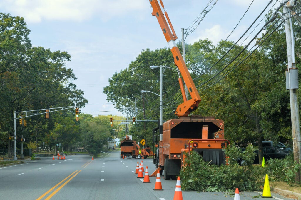

Historically, utilities have used routine trimming and in-person inspections to manage vegetation. But with labor shortages, rising costs, and wildfire risk increasing, they now need to evolve into risk-based vegetation management.

Yet traditional approaches are not working. Ground crews may spend weeks patrolling remote corridors on foot or by truck, only to cover a fraction of the system. Helicopter inspections expand coverage areas but bring considerable safety concerns and hefty price tags. And more than half of utilities admit their vegetation management funding doesn’t match operational requirements.
