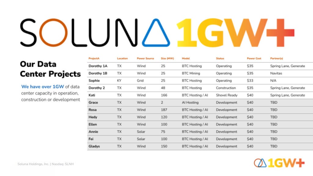

Soluna Holdings’ data center pipeline now exceeds 1 GW, spanning operating, construction, and shovel-ready projects across Texas and Kentucky. The portfolio includes its flagship 166-MW Project Kati, along with the Dorothy, Rosa, Hedy, Ellen, Annie, Fei, and Gladys projects, which integrate wind and solar generation with flexible Bitcoin hosting and AI workloads. Source: Soluna Holdings
Soluna Holdings’ data center pipeline now exceeds 1 GW, spanning operating, construction, and shovel-ready projects across Texas and Kentucky. The portfolio includes its flagship 166-MW Project Kati, along with the Dorothy, Rosa, Hedy, Ellen, Annie, Fei, and Gladys projects, which integrate wind and solar generation with flexible Bitcoin hosting and AI workloads. Courtesy: Soluna Holdings
Soluna said its partnership with Generate Capital positions the company for rapid expansion across its 2.8 GW development pipeline, which includes recently announced Projects Gladys (150 MW wind) and Fei (100 MW solar) that pushed the company past the 1 GW milestone in August 2025.
