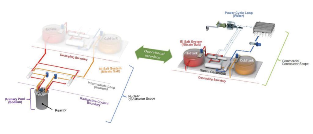

As POWER has reported in detail, the nuclear facility will mainly comprise a nuclear island (NI) housing the reactor (in a compact and simple safety envelope) along with its core and primary heat transport systems and an energy island (EI) containing the thermal energy storage tanks, steam generator, feedwater system, condenser, turbine, and supporting systems. The islands are designed to function independently with minimal interdependencies, connected only by the nuclear island salt system.
Diagram of Natrium's heat transport system for Kemmerer Unit 1, a Wyoming project featuring an 840 MWth sodium fast reactor and molten salt energy storage (Courtesy: TerraPower)
An overview of Natrium’s heat transport systems at Kemmerer Unit 1. The facility integrates an 840 MWth pool-type sodium-cooled fast reactor with a molten salt-based energy storage system to support dynamic power output. Courtesy: TerraPower.
