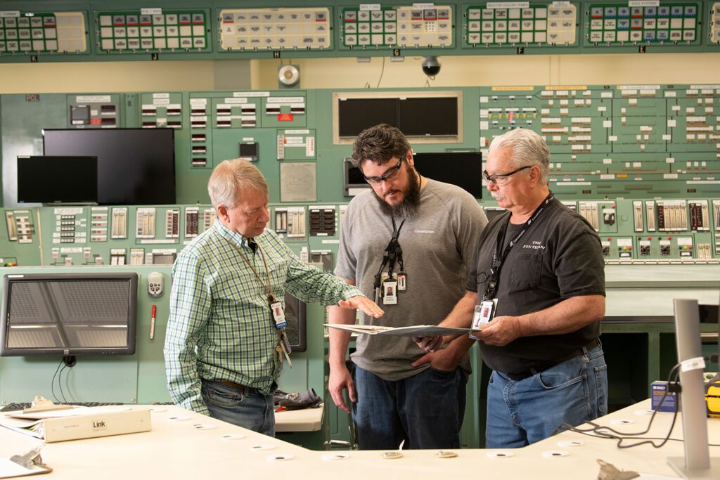

New operators receive hands-on training at the Crane Clean Energy Center as part of Constellation’s effort to hire and train more than 600 skilled workers for the plant’s restart. Courtesy: Constellation Energy.
