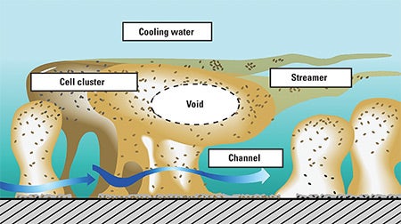

Microbiological fouling in cooling water is caused by biofilms (Figure 1). The biofilms are loose configurations of many different kinds of bacteria; a slimy substance they produce called exopolysaccaride (EPS) holds it all together. Biofilms, which cause dental cavities and diseases such as cystic fibrosis, are ubiquitous in virtually all kinds of water piping. In industrial processes, biofilms can cause corrosion and seriously affect flow, pressure drop, and the efficiency of heat transfer from metal surfaces (Figure 2).
1. Some need oxygen; others don’t. Biofilms live in a variety of environments, from aerobic, in cooling water (top), to anaerobic, near metal pipe surfaces (bottom). Source: P. Dirckx, MSU Center for Biofilm Engineering, Montana State University

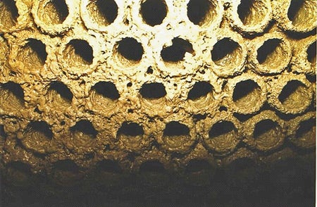

Biofouling limits heat transfer from condenser tubing. Courtesy: K.A. Selby

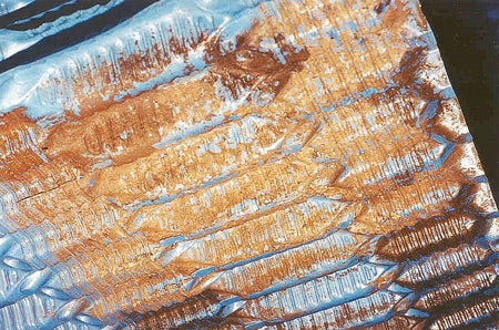

Biofilms also serve as collection sites for silt and other debris that can accumulate on cooling tower fill and lead to structural damage. They encourage the formation of scales such as calcium carbonate. Biofilms also can harbor populations of disease-causing bacteria such as Legionella and listeria.

Sticky wicket. At some point, using mechanisms that are not completely understood, free-swimming bacteria attach themselves to surfaces and form colonies. To form a biofilm, the bacteria excrete EPS and encase themselves in it. Although it is almost entirely water, EPS is extremely effective at protecting the bacteria from changing conditions in the outside world. EPS also excels at catching nutrients, suspended debris, and other bacteria, which improves the biofilm’s resilience and durability.
As the biofilms form, they incorporate and support many different types of bacteria. While bulk cooling water and the top layer of a biofilm may represent an aerobic (oxygen-rich) environment, in lower layers (adjacent to piping walls) the environment is anaerobic (oxygen-deficient). Different kinds of bacteria exploit the conditions in the biofilm that best suit them. If a biofilm spreads, so do the bacterial colonies. Bacteria on the portion of biofilm in the cooling water can be sloughed off and settle elsewhere to form more biofilms throughout the system.
Bacteria in the oxygen-rich outer layers are more active than those in the inner layers, which appear relatively dormant. Interestingly, studies show that that there are far more dormant bacteria in the interior of the biofilm than near its surface.

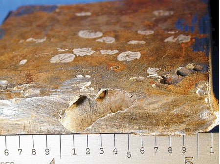

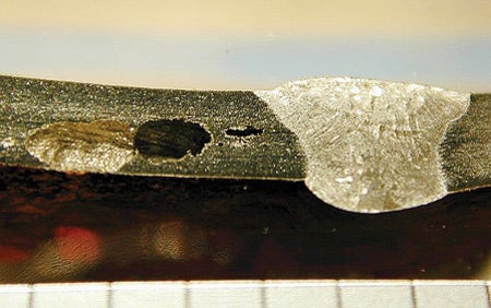

MIC can attack the stainless steel used in many cooling water systems in any of several ways. Once a biofilm has broken through the protective oxide coating, corrosion can proceed rapidly. The anaerobic conditions at the base of the biofilm prevent the protective oxide layer from reforming (Figure 3). The corrosion can be very localized and undercut in appearance. In some cases, the corrosion "tunnels" underneath the metal (Figure 4).
3. Urban blight. Bacteria from New York City’s East River were responsible for this severe pitting of 316L stainless steel in a power plant. Courtesy: M&M Engineering
4. Hungry critters. Biofilms in stagnant well water caused corrosion in 304L stainless steel adjacent to a weld. "Tunneling" commonly accompanies microbiologically induced corrosion. Courtesy: M&M Engineering

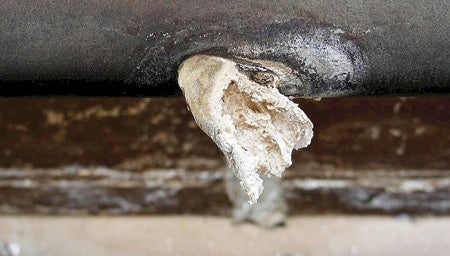

Bleached blond. Commercial or industrial bleach is available in strengths from 10% to 15%. It is manufactured by bubbling chlorine gas through a sodium hydroxide solution. Excess hydroxide is maintained in the final solution to increase the stability of the bleach (the strength of bleach decreases with time, exposure to UV light, and contact with a number of metals). Typically, commercial bleach has a pH between 11 and 13. At these highly alkaline levels, the bleach contains no hypochlorous acid, only hypochlorite ions. One possible consequence of the high pH is the formation of calcium carbonate deposits on bleach injectors, the result of the bleach reacting with "hard" cooling water (Figure 5).
5. Big deposit, lower return. The high pH of bleach caused the calcium carbonate deposits that are plugging this bleach injection line. Courtesy: M&M Engineering
