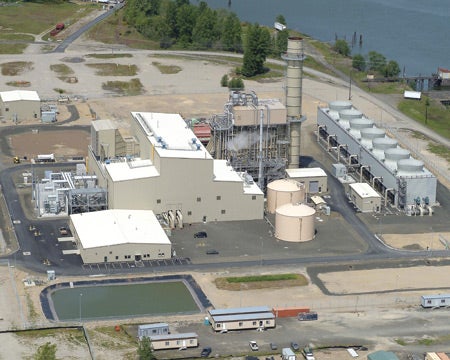

PWGP (Figure 1) is located in the Port of St. Helens industrial area of Oregon’s Columbia County, near PGE’s 545-MW Beaver Power Plant. Mitsubishi Power Systems (MPS, www.mpshq.com) supplied all of the equipment for PWGP’s 1 x 1 power island: a M501G1 gas turbine, an MHI steam turbine, generators for both units, and a triple-pressure heat-recovery steam generator (HRSG) from Deltak LLC (www.deltak.com) equipped with a selective catalytic reduction (SCR) system driven by CO and ammonia catalysts. Construction of the plant started in January 2005, and the project was finished under budget and just in time to meet PGE’s summer loads.
1. Push the button. An aerial shot of Port Westward Generating Plant, taken during its start-up in June 2007. Courtesy: PGE
