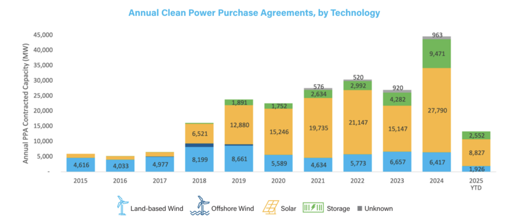

The group said the first six months of this year had 32% less capacity being contracted through PPAs than the same period a year ago. It said PPA announcements in the battery energy storage space fell a whopping 88% from Q1 to Q2, while announcements of wind power agreements were off 93%.
The report said corporate wind and solar PPA prices also moved higher, jumping 6% from Q1 to Q2, and are up 8% year-over-year. The ACP said higher costs are “reflecting the instability of the purchasing environment. Immense industry uncertainty led to stalled growth of procurements during the second quarter of 2025 compared to the previous quarter, as developers and purchasers awaited further clarity on changes to tax credit guidance and attempted to budget with shifting trade agreements.”

  • Procurement Falls Dramatically: The first half of 2025 saw a 32% decrease in capacity being contracted through PPAs compared to the first half of 2024. Other types of agreements are down 48%, compared to the first half of 2024.
