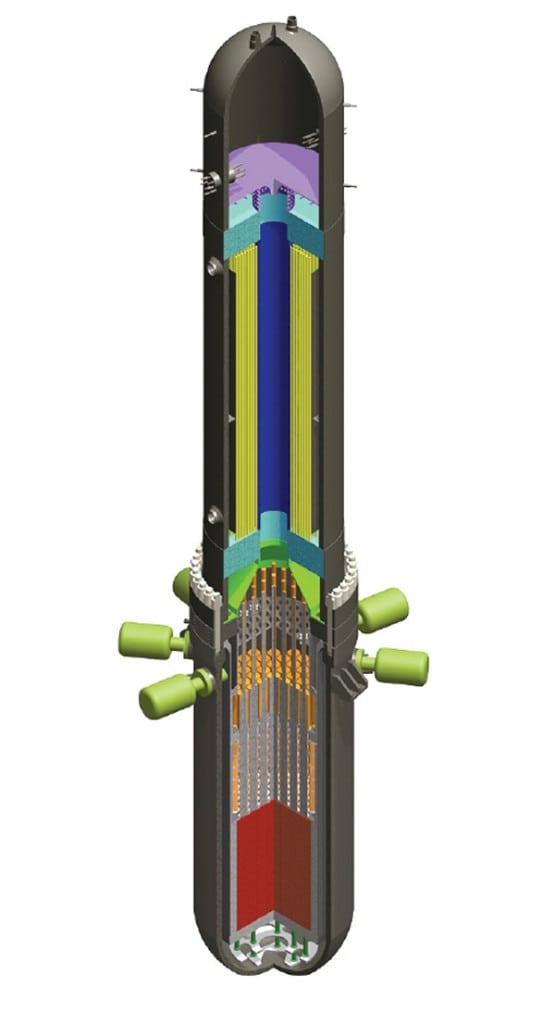

Figure 2_eVinciReactorSchematic_Westinghouse
2. Little wonder. Westinghouse’s eVinci micro-reactor design, an evolution of the Los Alamos National Lab’s Megapower concept, features liquid metal heat pipe technology, which is not common in commercial nuclear technology. It involves a core design that is built around a solid steel monolith with channels for both heat pipes and fuel pellets. Because heat pipes, operating in a passive mode at relatively low pressures, work to remove heat from the reactor core, the design has no primary cooling loop—and therefore no mechanical pumps, valves, or large-diameter primary loop piping typically found in all commercial reactors today. “Heat pipes simply transport heat from the in-core evaporator section to the ex-core condenser in continuous isothermal vapor/liquid internal flow,” the company says. Courtesy: Westinghouse
Westinghouse. Recently emerging from bankruptcy prompted in part by steep cost overruns at four large-scale AP1000 units that it began building in the U.S., Westinghouse is developing the eVinci micro-reactor (Figure 2), which ranges from 200 kW to 15 MW. Westinghouse says that it could develop and demonstrate the eVinci micro-reactor in less than six years, owing to its size and “high technology readiness level of individual components.” For now, it wants to develop a full-scale electrical demonstration unit by 2019 and then build an integral test with nuclear fuel, aiming for commercial deployment by 2024.
